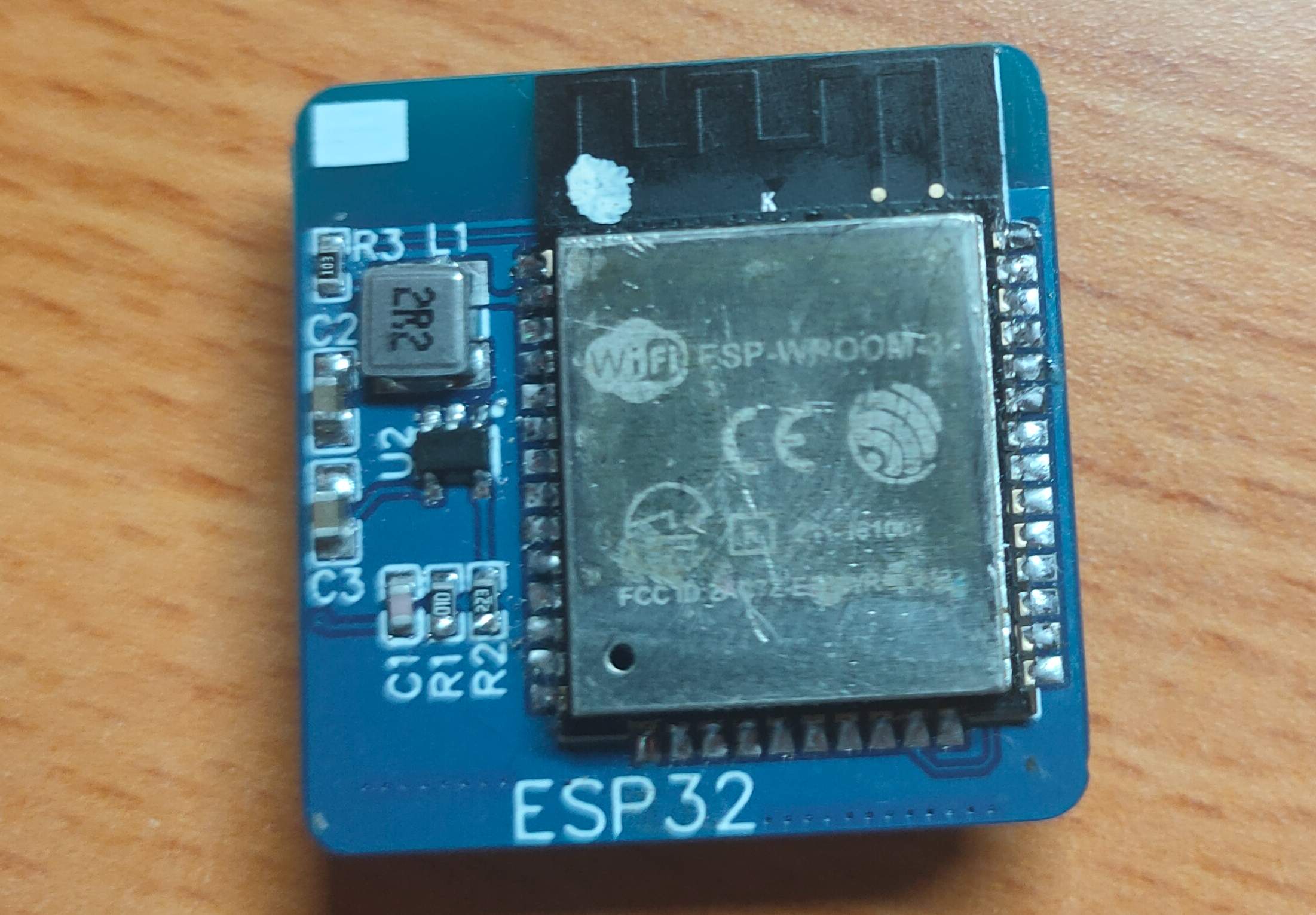

This MCU is a bit old, I only use this wroom32d because I have stock on hand.
The onboard SY8089 synchronous buck can output 3V3 power supply to the outside world. The input power supply is 5V. It has high efficiency and the maximum current output can reach 2A.
Use pin headers and female headers to connect to the base plate. 1.27mm 2x10P pin header and female header.
There is no onboard automatic download, so the download program needs to go through the baseboard onboard download module.
Conveniently use one core board for multiple baseboard projects.
