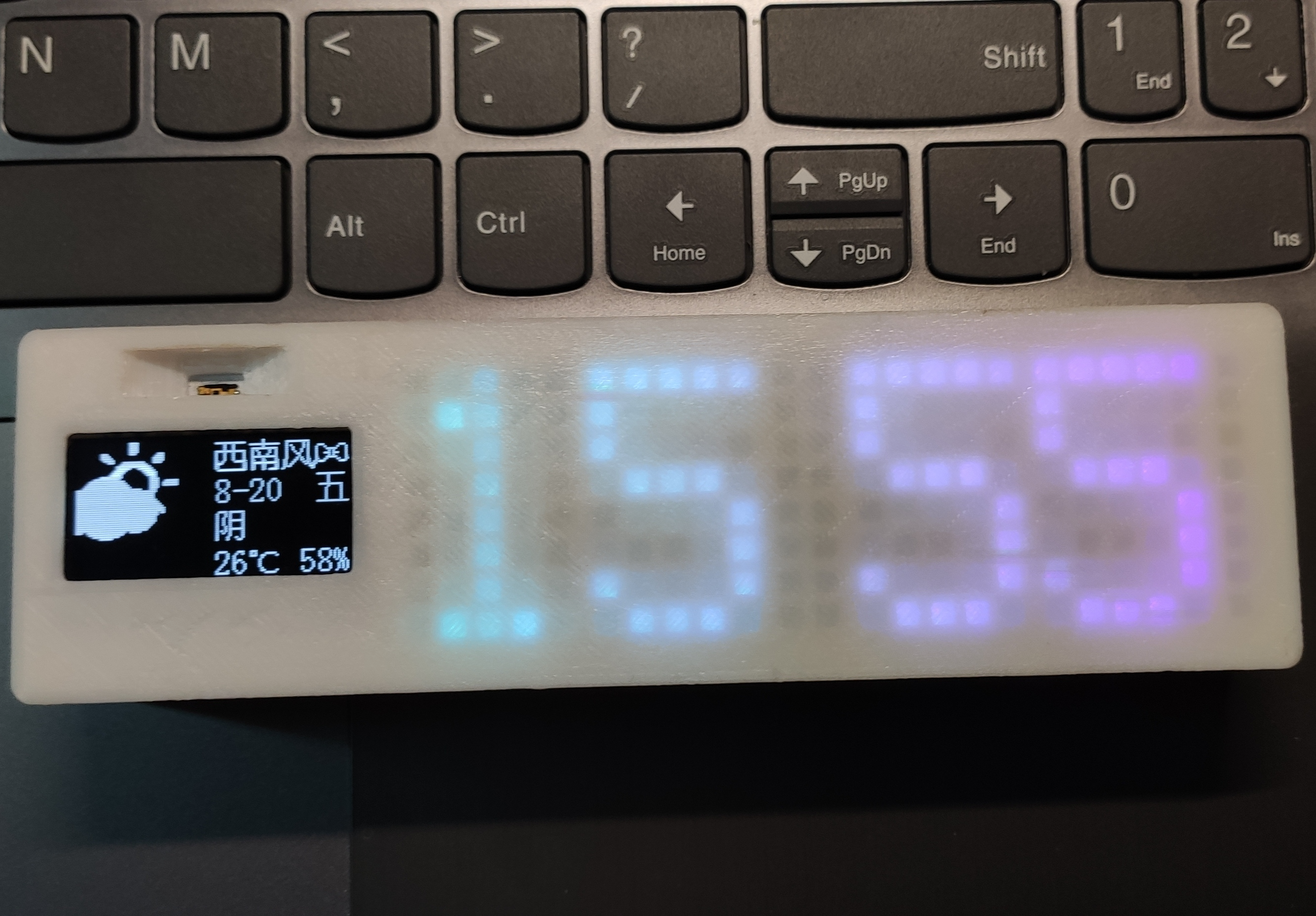

Equipment hardware overview:
1) The ESP12F of the ESP8266 family is used as the main processor to implement functions such as networking and data acquisition, and an STC8G1K08 is used as the sub-processor to drive the lattice.
2) The dot matrix uses LEDs of two colors, totaling 23*2 columns and 8 rows, to achieve multiple color changes and color gradients. The LEDs are half ice blue and half violet, and each pixel has one color (see the actual picture for details), please be sure to pay attention!
3) Integrated ambient light sensor to automatically adjust the brightness of OLED and dot matrix screens.
4) Integrated RTC, it can still operate normally for several years even if the power is cut off.
5) Integrated CH340 serial communication circuit and ESP automatic download circuit, which can facilitate firmware burning.
6) Integrated single-cell 3.7V lithium battery charging management circuit, the device can be powered by USB or battery. Recommended USB + lithium battery two-in-one.
7) The TYPE-C port is sinker plate 1.6, don’t buy the wrong one
Power consumption:
The average power consumption is about 0.3864W without turning on the power saving mode.
After turning on the power saving mode, the average power consumption is about 0.1512W
Average power consumption in night display mode is <=0.0798W
The above data are all measured when the lithium battery is fully charged at 4.2V. As the voltage drops, the power consumption will decrease slightly.
Device software overview:
1) Dot matrix screen) 256 levels of automatic brightness adjustment. Gradient or fixed colors at both ends of the color (11 types) or randomly switch to one of the above in 1 hour. Data update animation, decimal point-like water column animation.
2) OLED) 256-level brightness automatic adjustment. Full UI animation. Dynamic real-time weather icon display. Three-level menu button interaction (up, down, left, and right).
3) Network and location configuration) WiFi will prompt whether configuration is required after the connection fails at startup. There are also corresponding WiFi configuration options in the third-level menu. The location information is given in three modes: ① Fully automatic network positioning (poor accuracy, generally at the municipal level) ② Positioning by longitude and latitude (this method is the most accurate, but the configuration is more troublesome) ③ Current location pinyin input configuration (if the current location is not will not be queried in the database), there are prompts for the above configuration methods. The method is to automatically jump to the configuration page after the mobile phone connects to the hotspot created by the device.
4) Information update) Weather and weather forecast are updated every 20 minutes, and the time is synchronized once a day.
5) Data storage) All changed or configured data are automatically stored in the memory, and the data will not be lost when the power is turned off.
6) If the remaining battery power is higher than 4V, it will not be displayed on the LED dot matrix screen to improve the look and feel. The rightmost row of LEDs will turn on the power indicator when the power is lower than 4V.

Precautions
1) If you do not use USB power supply for a long time and use lithium batteries, be sure to turn on the scheduled shutdown and wifi power saving mode, which will greatly reduce power consumption.
2) Burn the sub-processor firmware first, otherwise the ESP8266 will occupy the STC serial port and prevent the program from being downloaded. If you have already burned a program to the 8266, you can also burn an empty program to the 8266 and then burn the sub-processor. Pay attention to the wiring on the PCB. When programming the sub-processor, reserve a pin header. V is connected to the 3.3V of the USB to serial port, T is connected to RXD, R is connected to TXD, and G is connected to GND. If the power supply is connected incorrectly, it will break down!
3) The button welding should be as close to the inside as possible (but not too far). You should choose according to the accuracy of the shell you printed, otherwise it will not be easy to install.
4) The 368 (like) LEDs I use are ice blue and violet from Uxin Electronics. Be sure to choose LEDs with colors close to the VF (about 3.2V), otherwise there will be a difference in brightness and darkness. When buying lamps at one time, be sure to make sure they are from the same batch to ensure consistency. Buy more lamps to prevent them from having poor consistency or being burned by welding.
5) The board was drawn in one go, so there are some shortcomings that I am too lazy to do the second version, such as ① Checking whether the USB plug-in circuit is not done (cannot automatically switch between power saving mode and performance mode). ②The RTC interrupt pin is not connected to the MCU and cannot be woken up regularly, so the ESP cannot enter sleep mode and the power consumption cannot be further reduced. ③The LED driver uses 595 as a constant voltage, which requires too high LED consistency. If it is replaced by a constant current driver, the effect will be better. Those who have the ability and motivation can make improvements on these points (of course, the IO of 8266 is too small, so you can optimize it by yourself).
6) I have not merged or repaired the printed files of the 3D model. I will repair them myself when printing. Otherwise there will be tears in some places. The thickness of the shell is modeled according to the lithium battery (103565 3000mah), so it is relatively thick. If you only need a small-capacity battery, you can change the thickness of the shell by yourself.
7) About welding) It’s time to test your patience and skills, go! The recommended temperature for soldering LEDs is 200° and low-temperature soldering. No false soldering.
