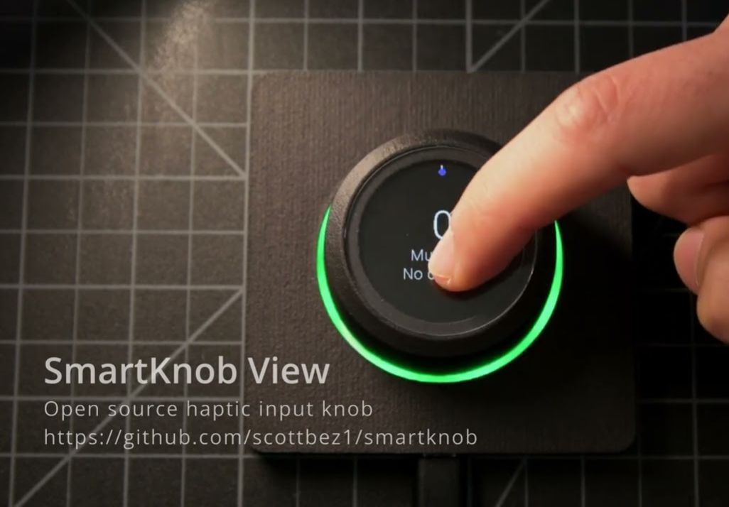

project originates from: https://github.com/scottbez1/smartknob
The purpose is to facilitate everyone to use this version directly under JLC PCB

There is no purchase channel for the original motor structure. It is difficult to 100% reproduce the original version.
2.1 The
micro pan/tilt motor model I used is 3205 three-phase brushless motor (there are two models) ) With NdFeB strong magnetic ring - Taobao (taobao.com)
2.2 Motor adapter
After replacing the motor, the previous shell will be 1mm smaller and needs to be adjusted. Please refer to the attachment casing-V0.02.123dx.
The new motor and the bottom circuit board are not the same. To match, you need to use a structural component to adapt, please refer to the attachment adapter-0808.STL (this file comes from QQ group 23691677)
2.3 The copper pillar
is used for threading in the middle and fixing the screen, model M2.5*25, I use M2M2.5 Double-pass hexagonal copper column M3M4 double-ended isolation column nut column support column motherboard computer stud M5M6-tmall.com Tmall
3 hardware
L1 is not welded, use 0R to replace
all seats and have not been purchased.
You need to prepare a little ultra-thin wire for direct welding. Multi-strand enameled wire connects the motherboard and screen
