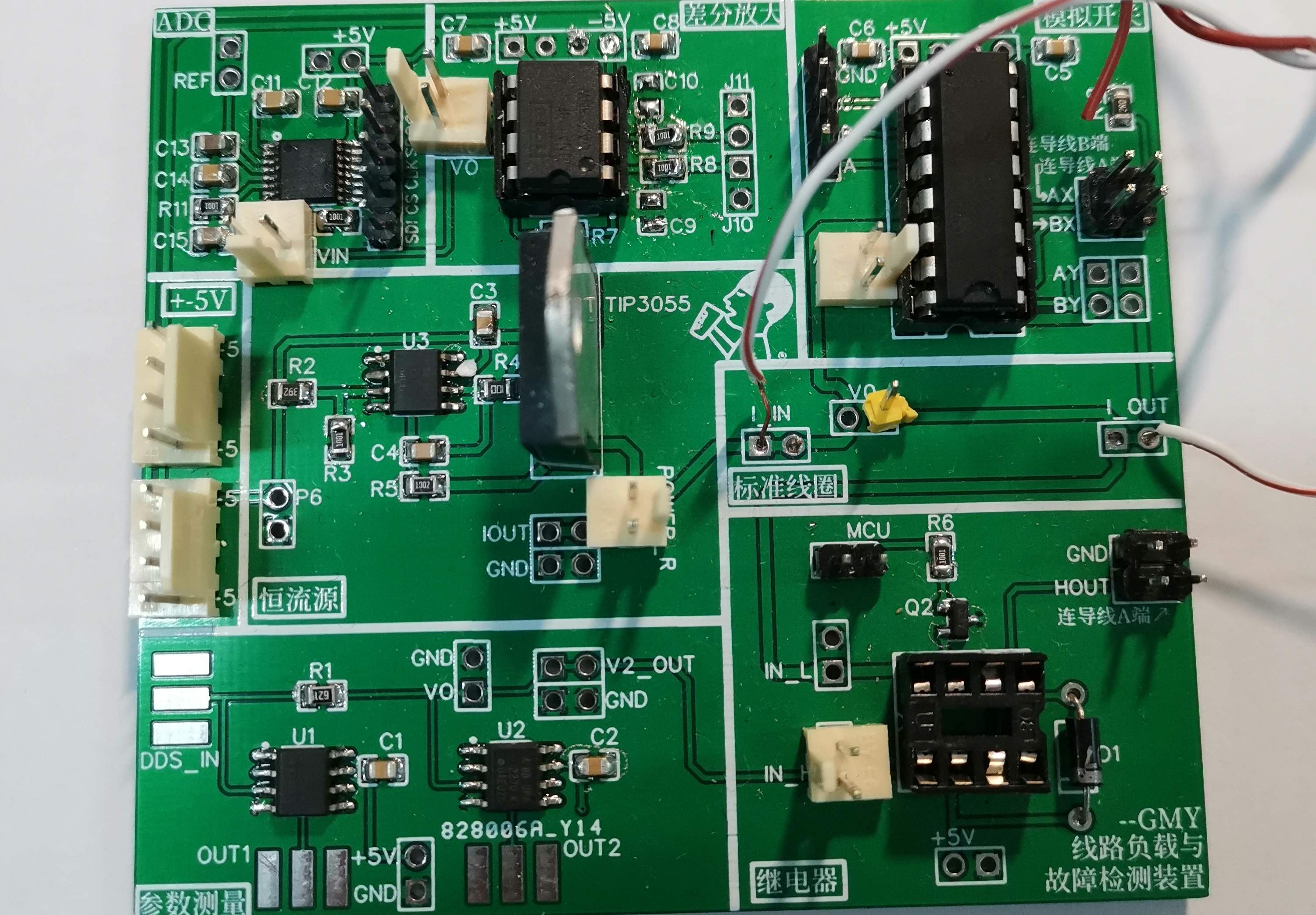

1. Current source
We adopted the 500mA Electronic Load solution in the routine Voltage_to_Current in TINA-TI to meet the large current of 500mA required by the problem, so that the wire resistance of a few ohms can be converted into a voltage of hundreds of milliamps, which is convenient for ADC measurement.
2. Relays and analog switches
      The signal frequency is not high, so the relay does not need to be a high-speed relay, just use an ordinary relay. We use the HRAH-S six-pin relay, which has a simple structure and is easy to control.
The analog switch uses CD4053, the voltage difference at both ends of the standard coil is connected to ax-bx, the voltage difference at both ends of the wire to be tested is connected to ay-by, and the common output is ao-bo.
ZqQrOpiVhx8yKKv3YSSYdbkMglkaEWMgJn5vNOux.png43QzBSO7WNBIcGGIZUxm1izNj0OzPYzZpNdJYgkx.png
3. Amplifier
      Since the voltage difference generated by the current source through the internal resistance of the network cable is small, and the output of the front-end analog switch is a differential signal, we choose the INA128 low-power precision instrumentation amplifier to amplify the voltage difference by 5 times, as close as possible to the minimum range of the ADS8691.
      The gain resistor selection is shown in the following table:
Dk4uFn0CMIioWfgwul6AWTLaTva38pEIc1RiOcty.png37V1dND0ErZ4AHlUdqUlnTPjn0gg5Lu7nNuIqUoL.png
Since noise needs to be added to the performance part of the problem, a 104 capacitor can be pulled down after R8R9 to form a passive low-pass filter.
