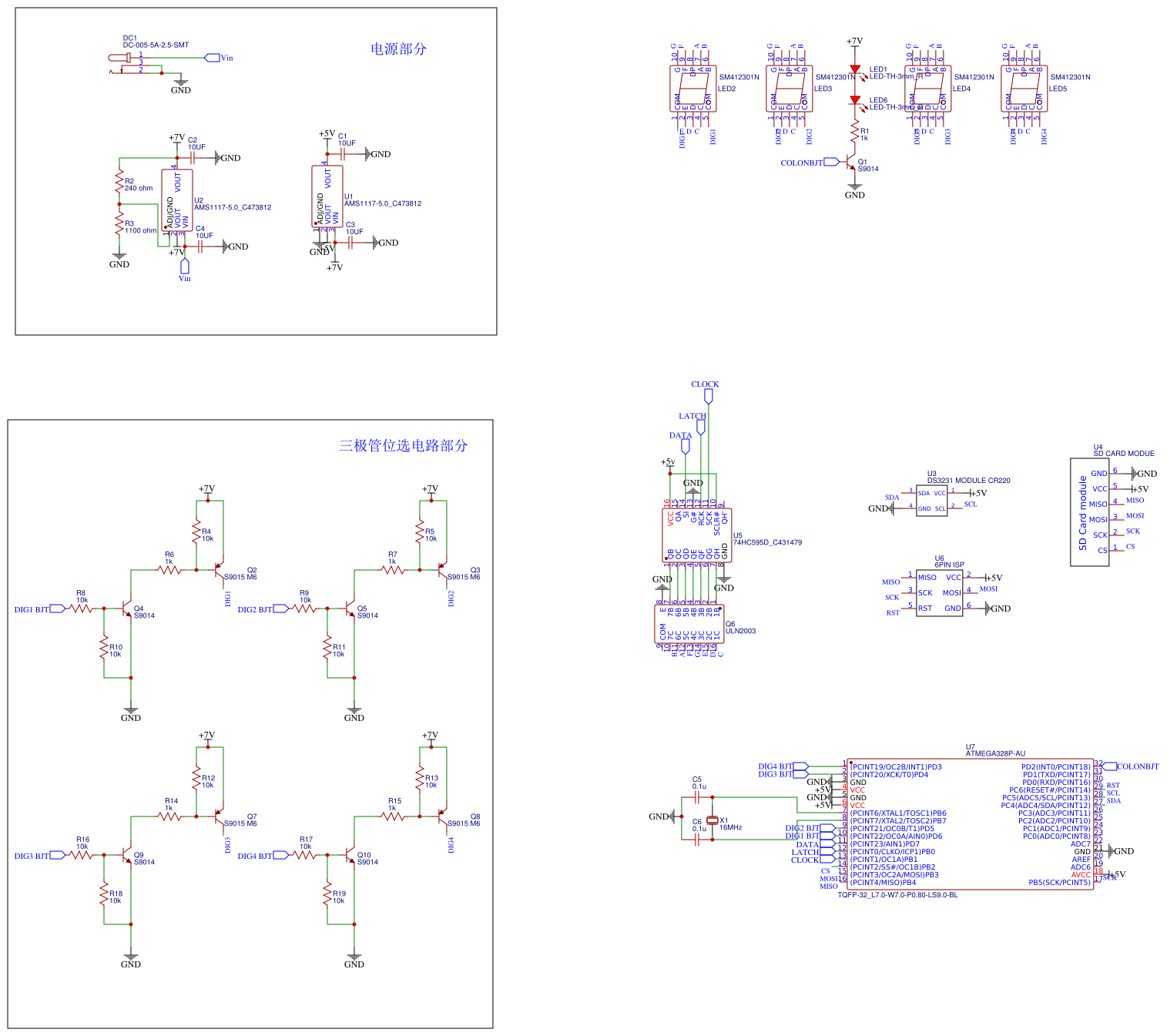

Large size digital tube clock base with arduino uno
//  Name    : 大号数码管时钟                        //
//  Author  : HOROLD FINCH                               //
//  Date    : 25 ApRIL, 2006                                      //
//  Version : 1.0                                               //
//  Notes   : 74HC595驱动 ULN2003驱动数码管          //
#include <Wire.h> // must be included here so that Arduino library object file references work
#include <RtcDS3231.h>
RtcDS3231<TwoWire> Rtc(Wire);
#define latchPin 8
#define clockPin 9
#define dataPin  7
#define siteselection LOW //for PNPBJT is HIHG,for NPNBJT is low

参考设计图片
