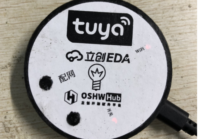

    Today I made the print file of the shell. The three-legged cat's modeling skills were difficult to draw the shell. Later, I found that the distance between the USB ports was wrong, but I cut it with a knife and it was fine.
final renderings
Instructions:
    After the mobile phone is connected to WiFi, open the Tuya APP. After the WiFi remote control is powered on, press and hold the network distribution button until the WiFi indicator light flashes. Then click Auto Search for the device in the APP. When the WiFi indicator light is always on, the device will be displayed on the phone interface. Click to add a device, and then you can configure the required functions.
