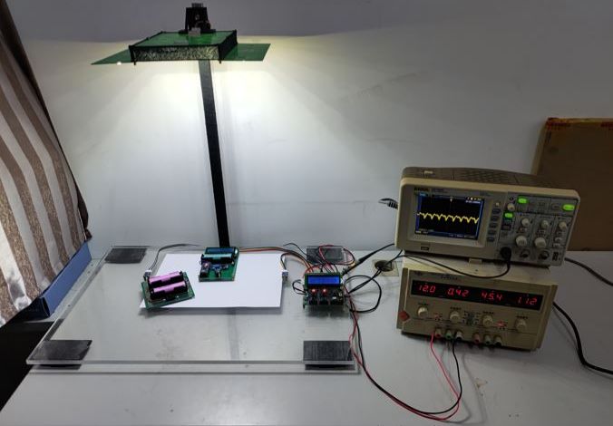

LED light board: We mainly use 3.3V LEDs with a power of 1W. Due to time constraints, we directly welded an LED light board with a perforated board. In order to solve the heat dissipation problem, we used all the voltage reduction work without considering the heat dissipation problem at all. , the actual power of each LED is about 10%--20% of the rated power. Although it causes a waste of power, it has ultra-high light efficiency. The LED light panel adopts a multi-area individually controllable solution, and several low-power LED lamp beads are set up as fill-in light, which greatly improves the uniformity of illumination.
 Main control: The Arduino nano development board is used as the core control board. The main reason for choosing it is that our laboratory has sufficient inventory of this thing, so we don’t have to waste precious competition time just to buy it, and the function speed fully meets the requirements.hnd4ZiwCsZ0cD87Bjj8IhbPFbdFR7UhR5VppFerX.jpeg
mini360 step-down module: Two mini360 modules are used, one is used to step down the power supply for 5v devices such as microcontrollers, and the other is used to provide constant voltage power supply for LED light panels; this module uses the MP1584EN high-efficiency voltage conversion chip, which is adjustable. Isolated buck chip, the maximum output current can reach 3a. We have optimized the circuit design, the ripple can be stably controlled within 2%, the efficiency can reach up to 95% or more, and the cost is low, only 2-5 per chip Yuan.
IIC LCD1602 LCD screen: The screen using the IIC interface not only saves the screen's occupation of the I/O port, but also reduces the workload and saves time; among them, we specially modified the 1602 to IIC adapter board to reduce the brightness of the LCD backlight to improve the overall The working efficiency of the equipment (although it cannot be reduced much, it can be reduced if it can be reduced)
LM321 operational amplifier: used for lamp board current signal sampling and amplification, I originally chose TP09, but found that the withstand voltage was too low (only 6V) and was easily burned by voltage spikes. Later I chose lm321, which has high withstand voltage and low power consumption. Low and cheap. (See the lm321 with two solder joints in the picture, it’s too small, haha)
Sensor: The light sensor uses BH1750, which has high precision and comes with built-in filtering. It can be used directly and is cheap, about 7 to 8 yuan a piece.
The display screen of this work can display the current, voltage, power and other data at the lamp board end of the desk lamp in real time. The voltage signal is sampled by a resistor, and the current signal is sampled by the resistor. It is filtered by a two-stage low-pass filter. The current signal is amplified by LM321, and the output is filtered again. The data are all measured using a multimeter. It has been verified and calibrated with an oscilloscope (we only have a multimeter and oscilloscope that can be calibrated here, there are really no better instruments, and the oscilloscope and power supply are from the laboratory decades ago)
Current and voltage sampling resistor section Amplification and filtering section
The actual objects are as follows:
(Oscilloscopes and power supplies from decades ago in the laboratory N5UeozRcglzvlPoeTvDzX04nWp9nKu5MmzVP199A.png)
The actual consumption of the entire work is probably less than 300 RMB (excluding power supply and instruments, etc.).
