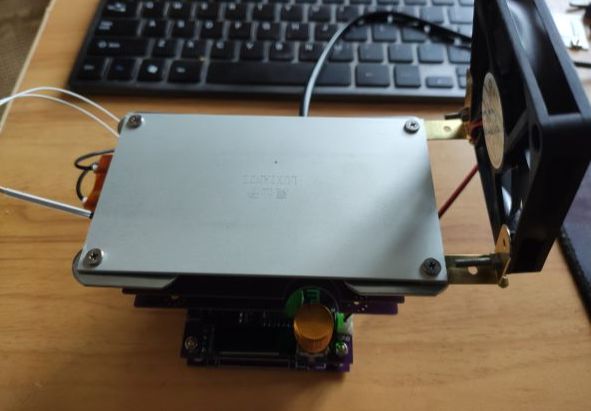

This project is based on the open source project of [Qifan Science and Technology] QF HP adjustable reflow curve multi-functional IoT heating table, and is a separate improvement for the heat insulation board. This heat insulation board can be equipped with Luxianzi's 400W or For a 500W vapor chamber, the original motherboard does not need to be replaced. You can still use the motherboard from the original open source project and simply replace the heat shield.
This solution can be equipped with a cooling fan for cooling in reflow mode.
With this insulated panel, you will also need to purchase metal connectors. .
400W vapor chamber, the required one-word connector can be purchased at Taobao's "Xiangzhen Flagship Store": the style is as follows:
The connectors required for the 500W vapor chamber can be purchased at Taobao's "Boutique Hardware Dongri Store". Just buy the smallest size. The styles are as follows:
Screws and washers are purchased at your own discretion.
