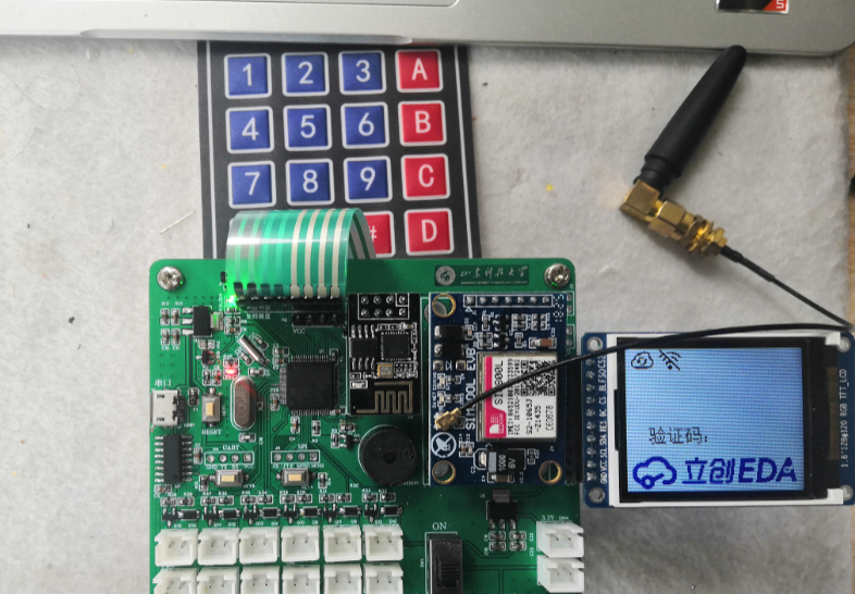

Basic functions include communicating with the server, controlling cabinet opening, displaying information, sound prompts, verification code input, etc.
The server and APP are made by others. I make the device side and use the following cabinet. Insert image description here
Solution selection
Solution: MCU + WIFI module + GPRS module + display + keyboard selection: stm32f103rbt6 + esp8266 + sim800 + lcd color screen + matrix keyboard

ESP8266 01S
Insert image description here 配置TCP透传,用到的AT指令如下:
AT指令 功能
AT 测试硬件是否正常
ATE0 关闭回显
AT+CWMODE=1 设置为客户端
AT+CIPSTATUS 判断状态:返回2表示已正常连接WIFI;返回3表示已正常连接服务器
AT+CWJAP="MyWIFI","123456" Connect to WIFI
AT+CWAUTOCONN=1 Set to automatically connect to WIFI mode
AT+CIPSTART="TCP","192.111.1.1",8888 connect to the server
AT+CIPMODE=1 Set to transparent transmission mode
AT+CIPSEND Start transparent transmission
+++ Turn off passthrough
Initialization flow chart: Insert image description here
How to handle return values
The basic idea is to open an array, store the received return value in the array, wait for a period of time after sending the command, read the array, and use the **strstr()** function to determine whether there is an expected return value in the array. , clear the array after the search is completed. Take the AT instruction as an example:
usart3_tx_dma_enable((uint8_t*)"AT",2); //发送AT指令
osDelay(50);    //等待50ms
if(strstr(mes_buf,"OK")!=NULL)  //找到对应字符串
    res = 1;            //返回1,否则返回0

1.8-inch TFT screen, SIM800L, ESP8266: picture.png
4x4 membrane matrix keyboard:
welding:
Washing plate: picture.png
After receiving the picture: Insert image description here
Test video link: Takeaway self-pickup cabinet test video
