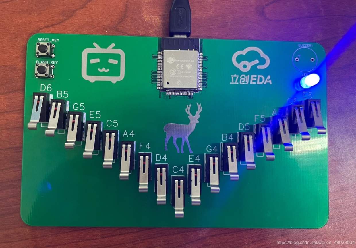

This design uses the real kalimba as a reference, and 鼠标按键uses the metal shrapnel shown in the figure below instead of the kalimba 蜂鸣器as the generating component.
mouse buttons
buzzer
Simply using a buzzer as a sound-generating component may not perform very well. Therefore, this project uses the ESP32 module as the main control, uses its Bluetooth function to connect to the mobile phone, and enhances its expressiveness through interaction with the mobile phone.
ESP32 module
ESP32 is a powerful IoT chip that can support WiFi and Bluetooth functions at the same time. It has 20+ available GPIOs and a running frequency of up to 240MHz. It can be developed using methods such as C语言, Ardiuno, etc.MicroPython
In order to simulate the feel of a real kalimba, before designing the hardware, we first measured the dimensions of the 17-key kalimba shown in the picture above , 尺寸and 键距 finally determined the size of 141mm*88mm and the key spacing of 7.6mm.
In addition to buttons and buzzers, a serial port chip is also used CH340for burning programs, and several WS2812colored lights enhance the music atmosphere.
The complete schematic is as follows:
MIDI Boy Schematic
MIDI schematic
PCB layout reference:
Insert image description here
In order to pursue aesthetics, all circuits are arranged on the back of the PCB board.
In addition, for the sake of beauty, the USB interface is placed below the antenna. This design will affect the wireless signal, so please do not imitate it!
