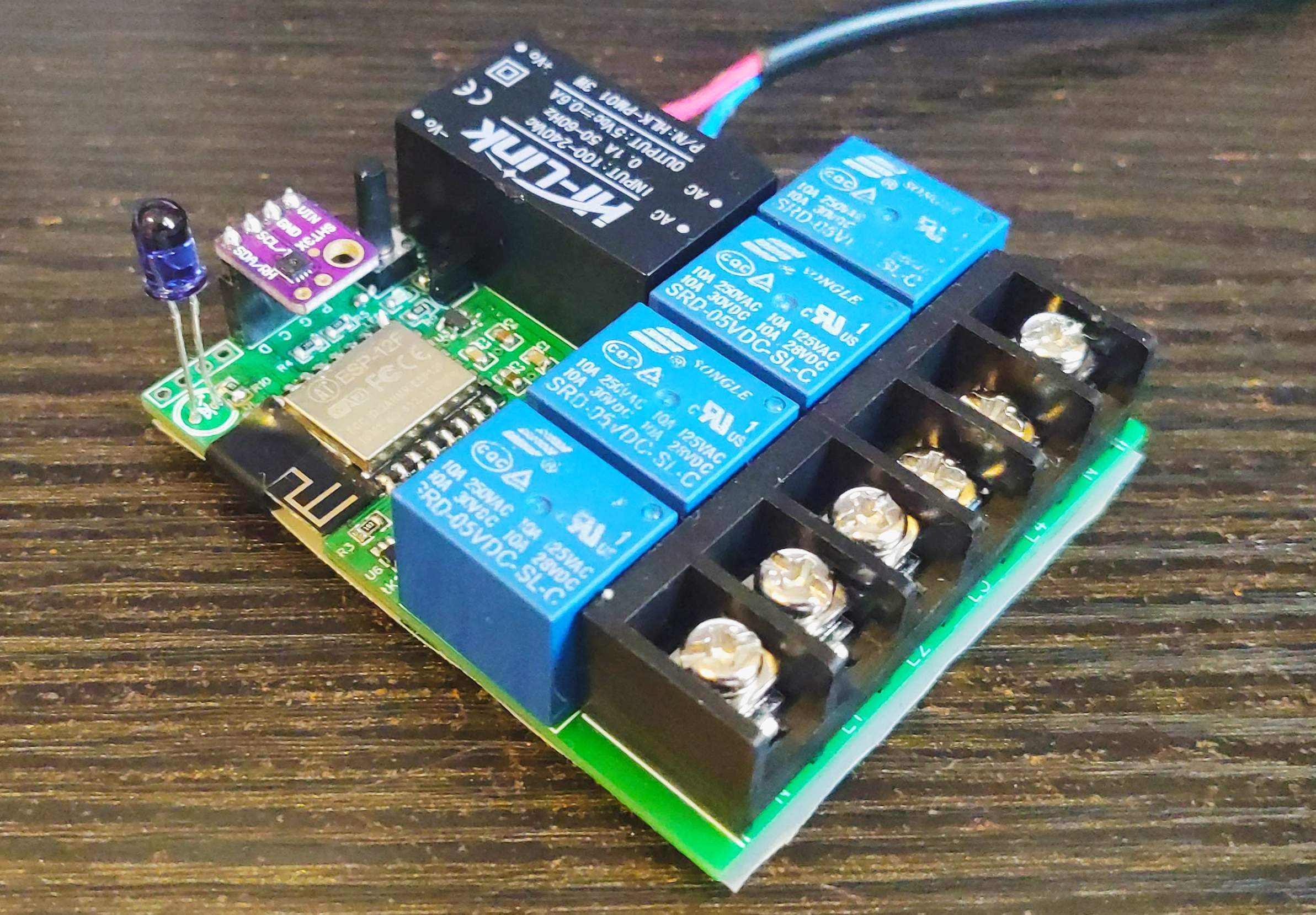

switch function
  • Supports independent control of four-way switches, providing greater control freedom
  • Support timing switch control, more intelligent
  • Supports voice assistant operations such as Google Assistant, which is convenient and fast
  • Buttons can control switches and air conditioning
Monitoring function
  • Supports detection of ambient temperature and humidity
  • Support key operation to display four-way switch status
  • (Abandoned for iteration) Support power detection
other functions
  • Supports being used as an infrared remote control to control other infrared devices (air conditioners, TVs, projectors, etc.), making remote control of non-intelligent devices possible
  • Supports one-click network configuration via mobile APP
  • Support IFTTT scene automation
  • Support OTA firmware upgrade
  • Connect to HomeAssistant private IoT platform , support multi-platform App and web client, public network HTTPS access
Technical features
The product is designed with practical applications in mind
  • Supports 100-240V ultra-wide voltage, more suitable for global use; plug and play, no need for other external power supply
  • The PCB design is compact, streamlined and small (7.43cm * 6.56cm), which is easy to embed into the socket, and connect to the socket of the socket with the shell and a single copper wire (or copper sheet)
  • The infrared remote control function supports the use of standard 38kHz equipment (air conditioners, TVs, etc.), and remote control learning functions can be added in subsequent iterations.
  • Focus more on commercial product design: no GPIOs are drawn out on the PCB, no circuits unrelated to practical applications such as USB-TTL serial ports are designed, and only test points for debugging are retained.
  • The temperature and humidity sensor uses a female base or flying wire, which can better expose the sensor to the environment to ensure collection accuracy. The humidity error is +-3%RH, and the temperature error is +-0.3°C.
  • The software supports OTA (Over The Air) firmware upgrade. Users can easily upgrade the device by operating the client, and the cloud can also promptly repair major software vulnerabilities.
  • One-click network distribution technology based on espressif's SmartConfig Demo
Hardware selection
type model Advantage cost
Main control+Wifi ESP8266-12F It has a high main frequency, strong processing performance, and low cost, making it very suitable for use in node-type smart devices. ¥8.86
AC-DC HLK-PM01 It has a powerful output capability of 5V@3W. The output voltage and ripple are very stable and can be used to drive four relays. ¥19.29
LDO SPX3819M5-L-3-3/TR Compared with AMS1117, it saves considerable space, and its 500mA output capability is sufficient to handle high-power RF circuits. ¥0.86
drive NUD3105DMT1G The ultra-small package inductive driver saves the huge space occupied by dual MOS with the same principle. ¥1.66 * 2
drive 74LVC2G14GW Inverter to prevent the relay from being accidentally triggered when the main control is reset. ¥0.37 * 2
sensor ACS715ELCTR-05B-T A sensor based on the Hall effect with ultra-high response frequency (unfortunately, the bias voltage of Vout's VCC/2 was misunderstood) ¥12.21
sensor SHT30 Temperature and humidity sensor with lower temperature drift and higher accuracy, and extremely fast response speed ¥11.30
relay SRD-DC5V-SL-C Songle is a professional relay factory with a history of more than 20 years. Its quality has been certified by authorities from Germany, the United States, China and other countries. ¥2.11 * 4
human-computer interaction
voice control
Currently, the following functions of Google Assistant voice control are supported:
  • Turn air conditioner on or off
  • Set air conditioner temperature
  • turn on off light
  • Turn on or off individual or all switches
client
Regarding user operation experience, a user-friendly client and interface cannot be underestimated. The open source HomeAssistant project is used here, which supports IoT devices and even vehicles connected to unknown protocols of some third-party companies.
  • Second response, second start client operation interface; supports HTTPS access, more secure
  • Highly supports UI customization
  • Custom device supporting MQTT protocol
  • Supports common smart home functions such as IFTTT and scenes
server
In order to cope with various complex network environments and the difficulty of MCUs in dealing with network protocols, we chose the MQTT protocol to ensure efficient, fast and stable transmission of signals. As we all know, the MQTT server in the MQTT protocol is very critical. It is responsible for forwarding subscription and publishing information from devices and users, so it is a key transfer center. Here we choose the EMQ MQTT server developed by Chinese people. The operating environment is Debian10, and the service operation failure rate is extremely low.
  • Support public network devices accessing MQTT server
  • It has a graphical management interface to facilitate debugging and management of subscriptions, topics, clients, etc.
other
More in-depth testing
In order to enable smart devices to cope with more complex actual application environments and more demanding network conditions, I simulated some actual possible faults and made some solutions.
  • No Wifi/Don’t want to configure the network: Prevent some applications from being unable to connect to the Internet and throwing exceptions when the device does not have Wifi.
  • No Internet: Prevents MQTT from being unable to connect to the server and causing an infinite loop, causing WDT to be reset due to the inability to feed the dog.
  • Human-machine experience optimization: Prevent the platform from delaying receiving status information after button operation
  • Bug fix: hair loss
Existing flaws
Since it is only the first version of the PCB and has not been iterated yet, there are some initially considered features that have not been implemented.
  • The ACS712 current sensor currently exceeds the ADC range of the ESP8266 due to the bias voltage, making it impossible to measure.
  • Indicator LEDs and infrared LEDs multiplex the same GPIO. Future expansion functions may limit the richness of LED indication functions.
  • The GPIO2 where the button is located will affect the selection of the ESP8266 startup mode. Therefore, when the user presses the button when powering on, it may affect the use of the product and affect the user experience.
  • At present, the GPIOs of ESP8266 are almost all used up, but after debugging in the future, the serial port can be disabled to add two GPIOs.
