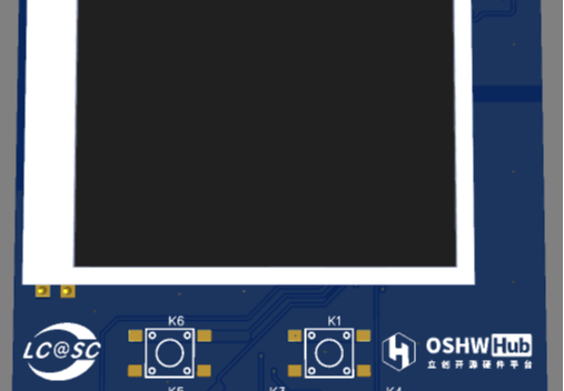

This oscilloscope uses the HK32F103RBT6 Hangshun chip as the core main control microcontroller, and the screen uses a 2.8-inch TFT LCD screen

This small handheld oscilloscope only has a bandwidth of 200KHz, but it is good for measuring low frequencies or situations with low requirements. It can also be used to initially learn how to use an oscilloscope.
