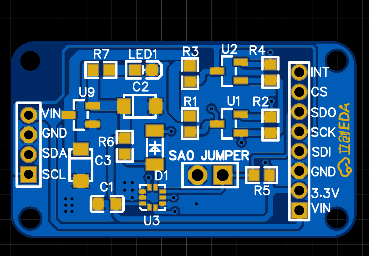

The project mainly includes the following parts:
  1. Main chip circuit
  2. Input voltage conversion circuit
  3. MOS level conversion circuit
  4. I2C/SPI mode switching circuit
  5. I2C address change circuit
Precautions:
  • The recommended power supply voltage range of the chip is 1.7-3.6 V, and the maximum cannot exceed 4.8V. This design converts VIN to 3.3V as the power supply.
  • Pay attention to the high and low levels of the signal. The maximum voltage of each signal pin of the chip is VDD_IO+0.3. In this circuit, VDD_IO is 3.3V, that is, the maximum input of each signal pin is 3.6V. The high level of a device like Arduino is 5V, which may damage the chip. Need Convert the input 5V high level to 3.3V high level.
  • See the text in the schematic diagram for specific comments.
