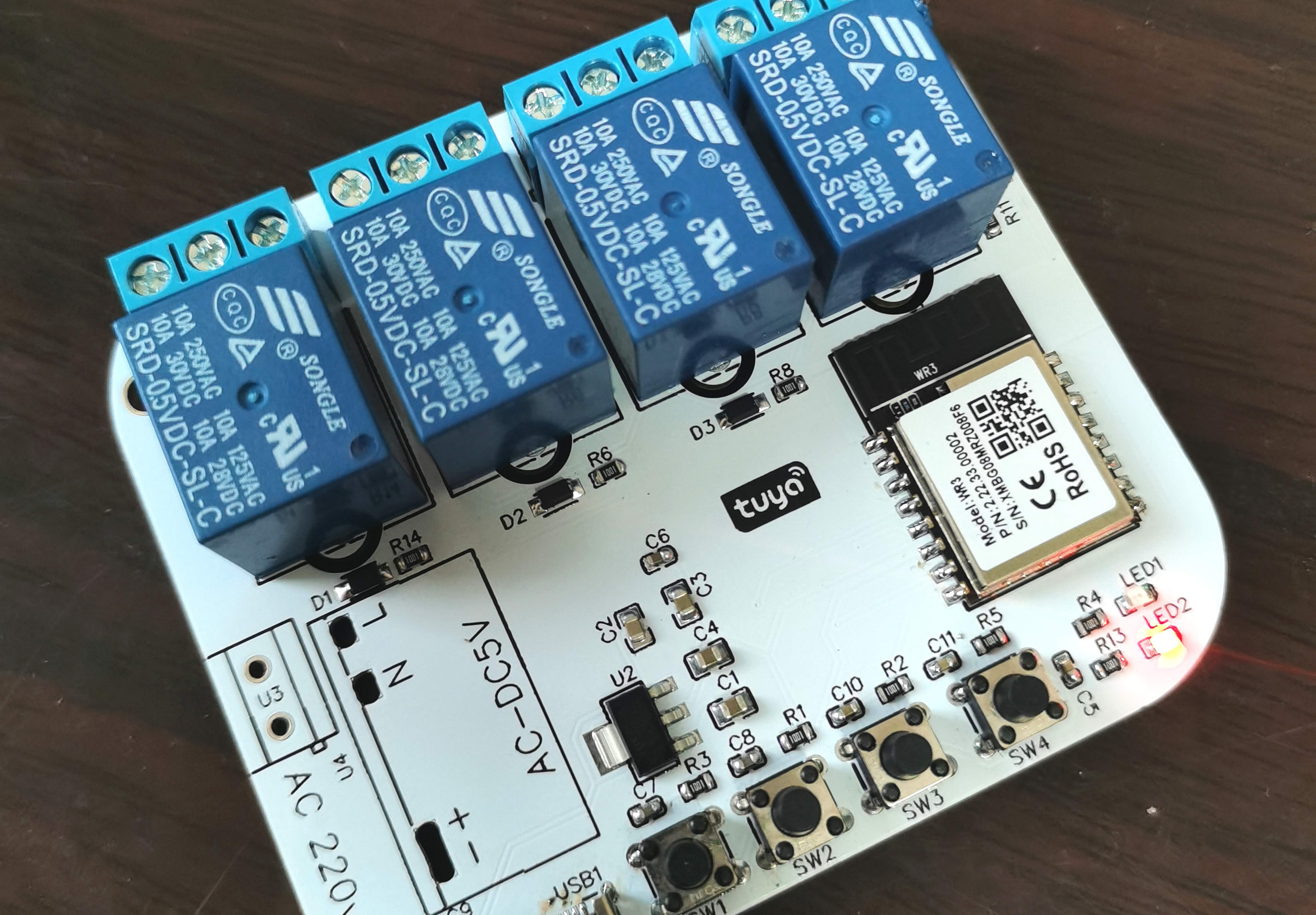

Tuya four-way relay switch
Note: This project does not require Tuya smart Zigbee gateway
OEM clone link: Click here to clone Tuya four-way relay switch
Developed using Tuya Smart Platform WR3 SOC solution. WR3 is a low-power embedded Wi-Fi module developed by Tuya Smart. It consists of a highly integrated wireless radio frequency chip RTL8710BN and an external flash chip. It has built-in Wi-Fi network protocol stack and rich library functions.
Function:
1. Bi-directional power supply, can be powered directly by AC 220V power supply, or via micro USB;
2. Connect to home power supply and can set inching/self-locking;
3.1-4 channels are independently controlled, can be connected to the Tuya platform in scene linkage, and support voice assistants such as Xiaodu.
user terminal:
The actual measured standby power consumption is about 0.05A, and the four-way full pull-in is 0.4A.
