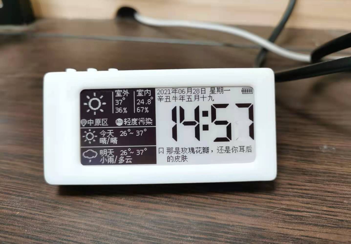

The ink screen weather firmware imitates DUCK interface effect and is compatible with DUCK hardware.
It is recommended to use the latest version of Tangtang hardware with power switching.
The firmware is based on a deeply modified version of the glycyrrhizinate open source program and is adapted to the Dalian Jiadian three-color screen.
The power icon is displayed and a customized sentence is displayed.
Percent battery, automatically obtain a word
Firmware function description:
1. Compatible with Yuchen’s 2.9-inch screen, or the Hink screen using E029a01 silk screen. If you need to adapt the screen, you can submit it. After adaptation, the firmware will be sent to the QQ group
2. The weather source is Japanese weather , and you need to register a developer account to obtain the key. Cities can be specific to the county and district levels, and can be obtained 2,000 times a day for free. The weather icon adopts the Japanese weather standard icon, and there will be no icon loss.
3. The Yiyan interface comes from Yiyan , and occasionally the message is empty. You can also customize the message. By default, GL is displayed in one sentence at startup, and it can be cleared by sending a blank. Custom messages are the highest priority, server push messages are also accepted.
4. The network configuration method is the same as that of DUCK firmware. Press and hold the third button, press and release after the first screen refreshes.
5. The power display icon or percentage can be switched, and common functions such as customizing a sentence and not updating at night can be used. Sleep power consumption is 32ua.
6. For example, in Shenzhen City, generally you only need to fill in the city as Shenzhen City to obtain the information. You do not need to fill in the superior administrative district. You need to specify a certain district in Shenzhen City to fill in the superior administrative district as Shenzhen and the city as XX District.
7. The firmware update function is retained, and the firmware or file system can be updated via WEB later.
Version update V1.03:
1. Solve the problem of not being able to obtain the city ID. After modification, you will be able to obtain it by filling in the information according to the instructions.
2. Add the weather display method when there is no temperature and humidity sensor.
3. Solve the problem that the key is not filled in when the KEY already exists. After solving the problem, the KEY only needs to be filled in once.
