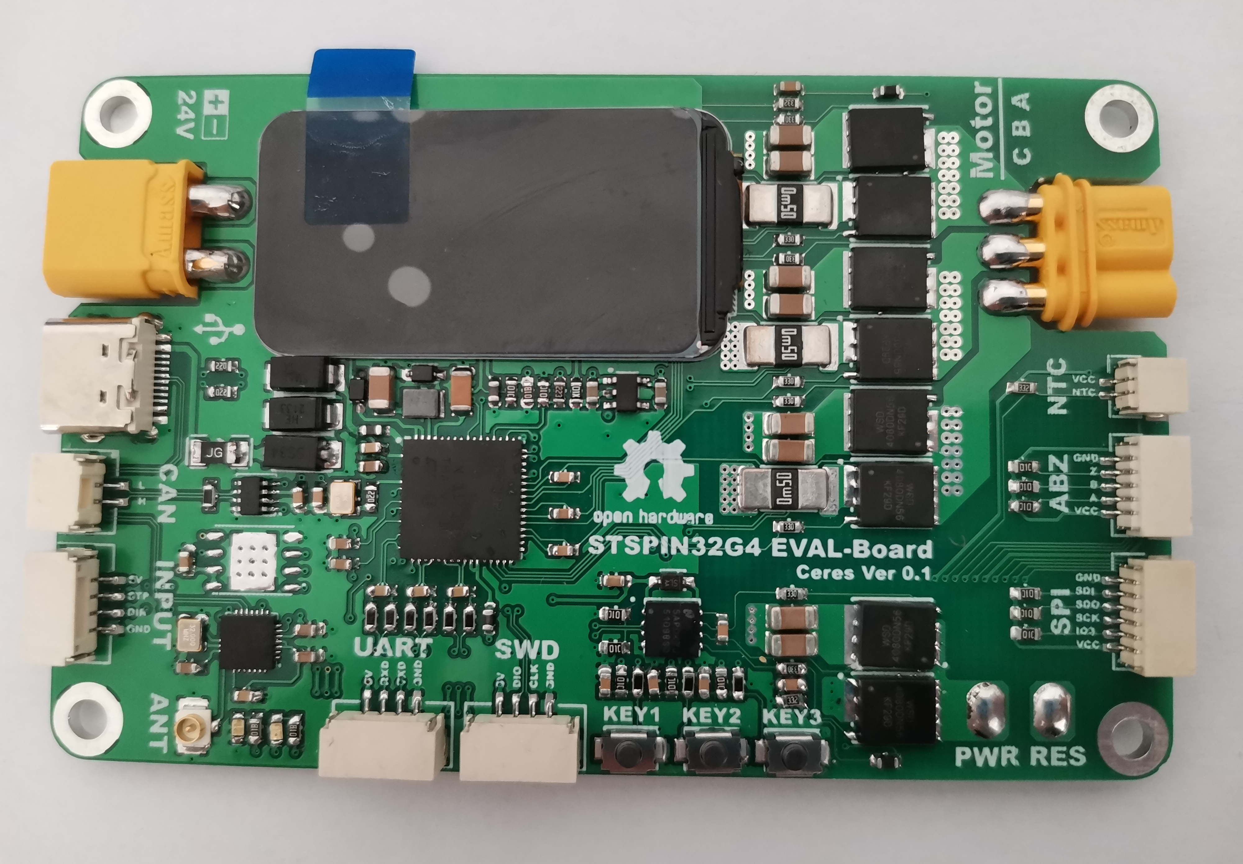

STSPIN32G4VB-Motor driver evaluation board
The main control and gate driver chip is the motor-specific chip STSPIN32G4 produced by ST Company;
Onboard CH9143 Bluetooth USB serial port three-way chip allows wireless debugging;
Integrated power dissipation circuit enables energy-consuming braking;
When welding MR30 and XT30 in horizontal position, the height of the board can be limited to about 6mm;
Type-C plugs forward and reverse to switch USB and serial ports;
Motor temperature and MOS tube temperature sampling;
