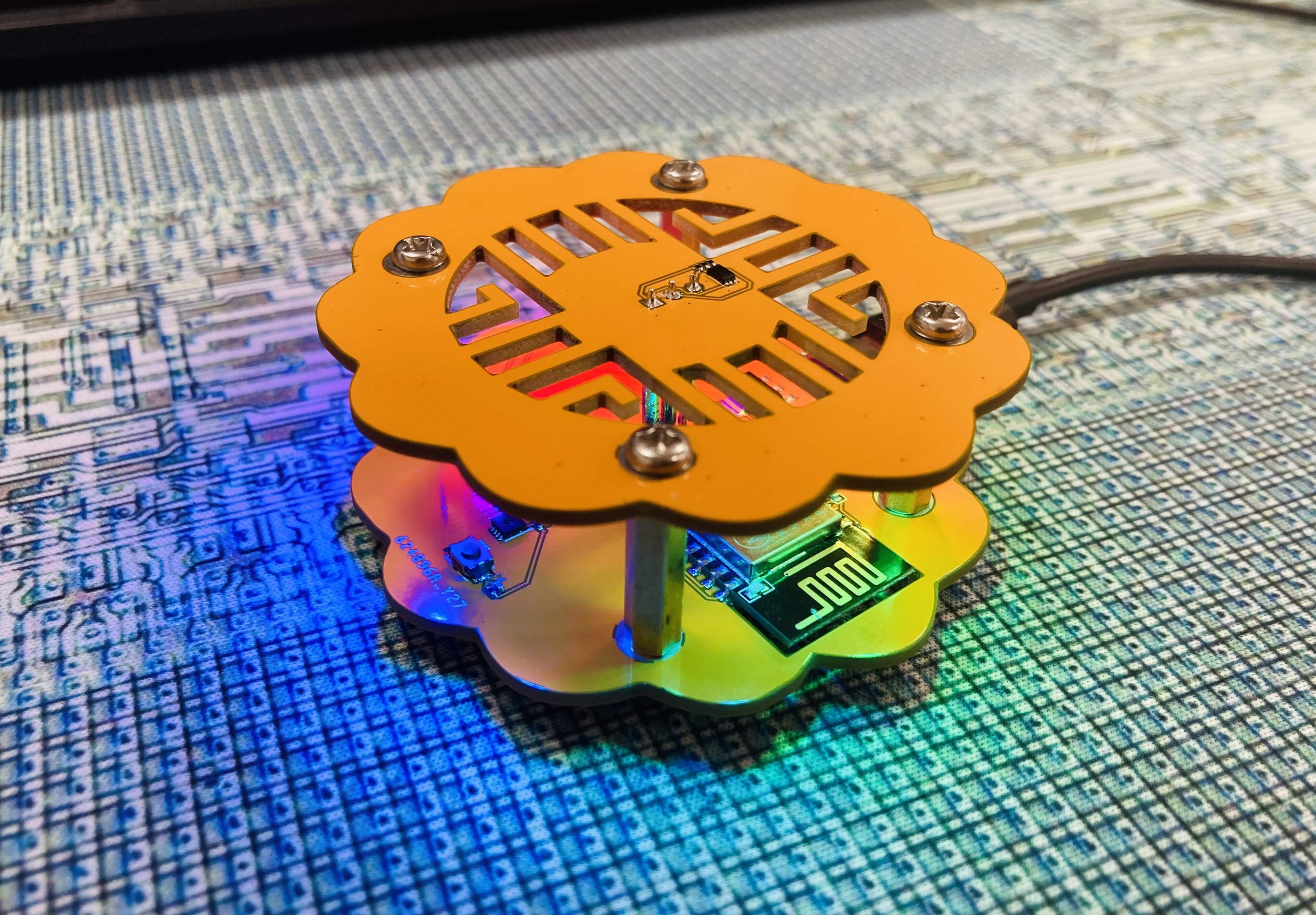

An RGB mooncake, using ESP12F as the main control chip. Onboard SHT30 temperature and humidity sensor, light sensor. Interactive display through 10 5050 WS2812. ESP8266 web-side interactive control (under development)
The whole board uses Juezan 0402 devices, using copper pillars to transmit signals, with an upper and lower two-layer design, and the RF antenna window is open without interference. IMG_1481.JPG
