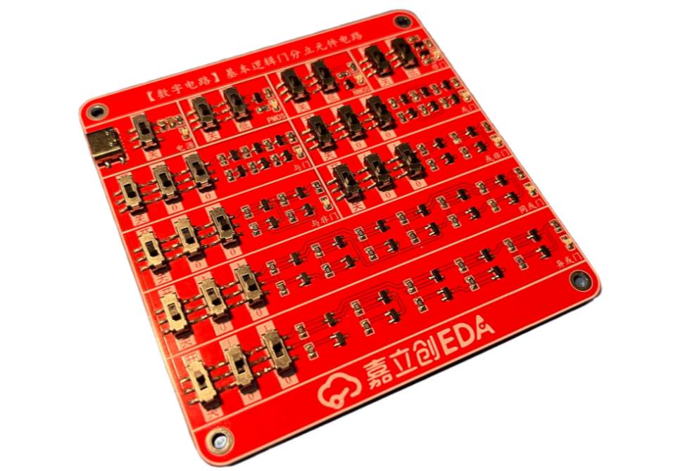

1. Project Introduction
  Logic gate is the basic unit in digital circuit, which can realize various logical relationships. The basic logic gate discrete component circuit is built with MOS tube to realize the verification of logical operations such as AND, OR, NOT, NAND, NOR, XOR and XOR.

3. Project design
1. Schematic design
  First, open Jialichuang EDA, create a new project and name it [Digital Circuit] Basic Logic Gate Discrete Component Circuit, and name the schematic file: SCH_Basic Logic Gate Discrete Component Circuit.
  Secondly, device selection is carried out. All components here are surface mount devices. Components can be searched in the component library of Jialichuang EDA. Each component has a unique product number in the LiChuang Mall. The power interface uses a 6-pin TYPE-C female socket, and LEDs are used to display and verify the operational relationship of each logic gate.
  Finally, draw the circuit schematic. Each logic gate is drawn according to the module circuit division, and the function of each circuit is indicated. The symbols, truth tables and expressions of each logic gate are added to facilitate understanding and learning.
