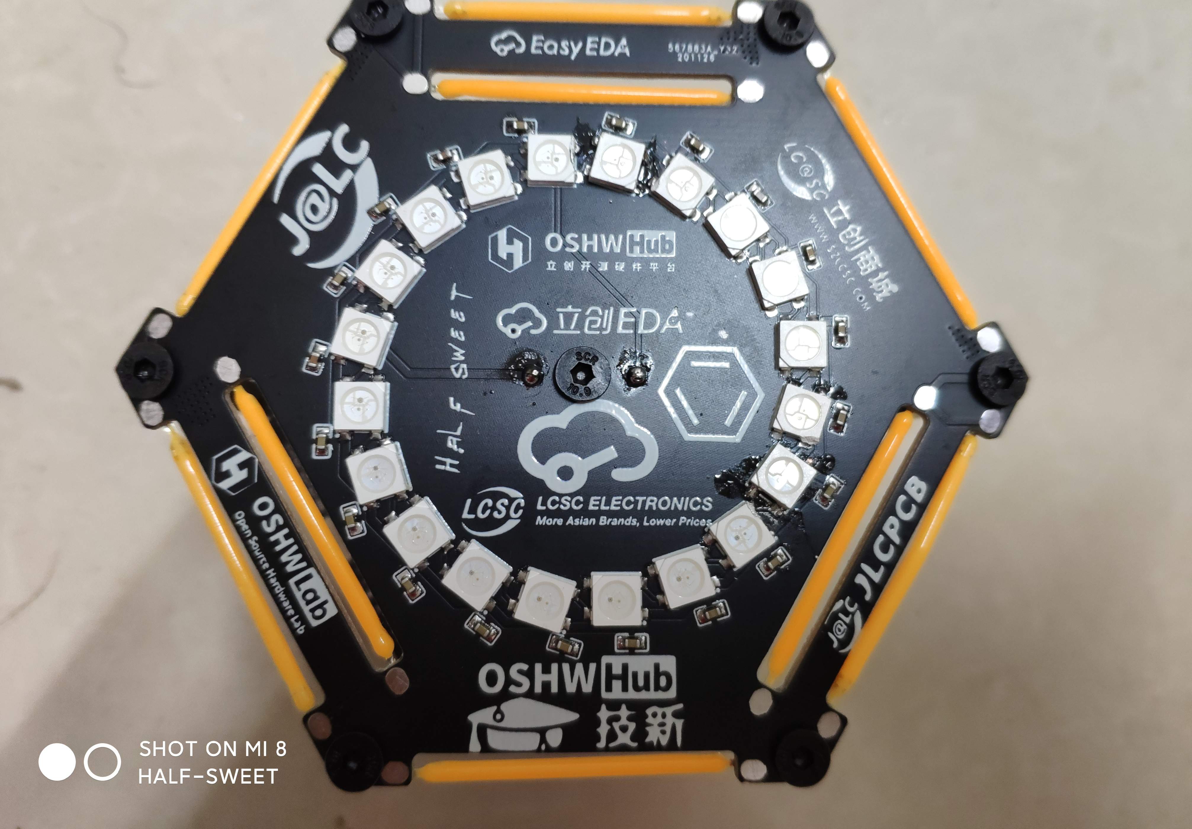

Control panel front Back of light panel family portrait
6. Display of soldered PCB
The front of the welded light panel an angle another angle another angle
Maybe some students are going to complain about me, eh, why are all your photos taken at an angle? Because...this damn camera level is crooked, so everyone just bear with it and live to see it.
