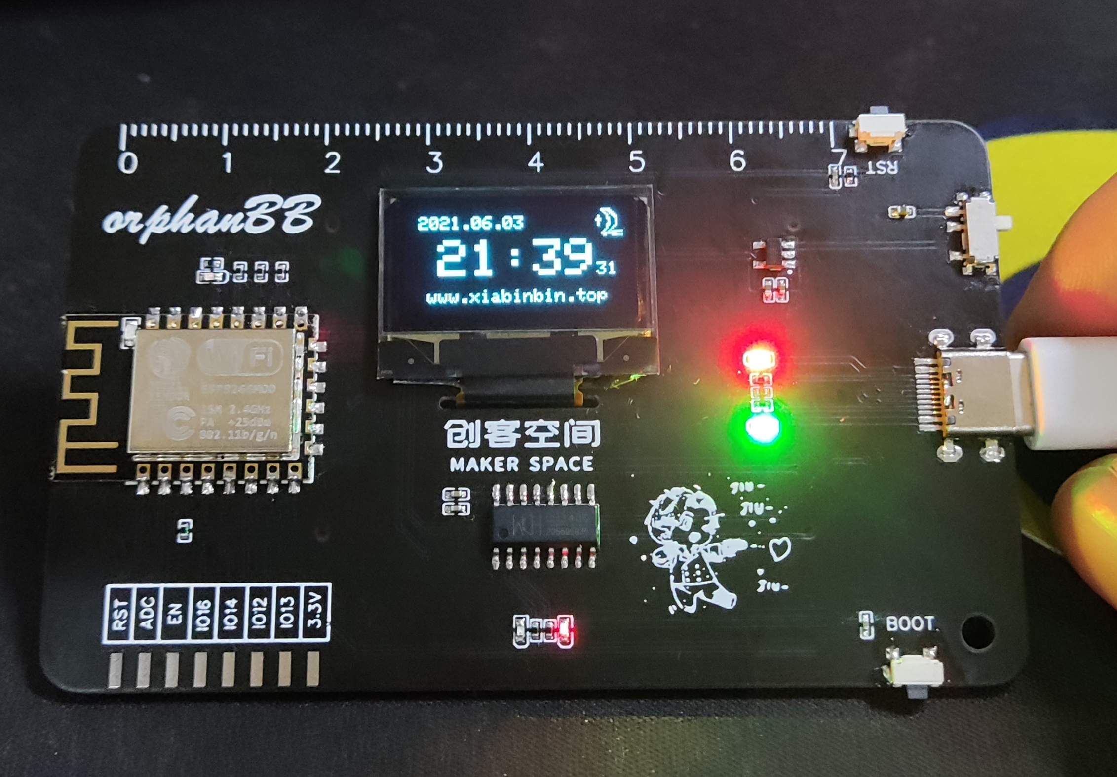

I just finished the final design of stm32 recently. Since the price of stm32 has increased seriously now, I want to play with the ESP series. I made an ESP-01S OLED electronic clock on a perforated board. I feel that it is not comfortable to use the module, so I want to make one. board. First of all, this board must be an ESP8266 development board. Secondly, it must have an OLED screen. Finally, consider making it into a card, which can also be used as a small gift for the students in the laboratory. IMG_20210603_213916.jpg

  • ESP-12F
  • CH340C serial port chip
  • IIC interface 0.96' OLED
  • Power Indicator
  • Onboard programmable LED
  • GPIO lead out interface
