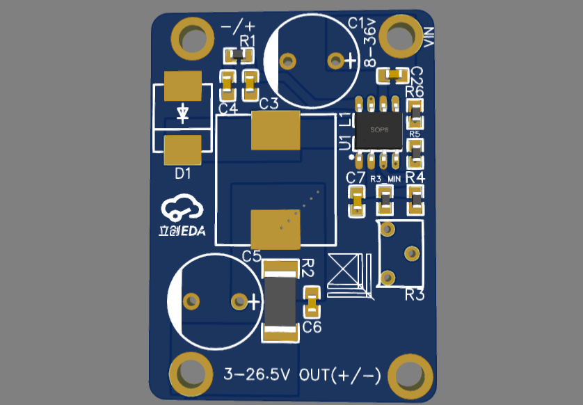

EUP3467 adjustable voltage 5A buck module supports CCCV
Input voltage 8-36v Output voltage 3-26.5V (not specified in the data sheet, this range is the voltage control range of the FB resistor group in the project) Input and output current does not exceed 5A
The potentiometer controls the output voltage. The schematic diagram contains the calculation formula and the reference resistance drawn by me. If the resistance of the potentiometer is 0, the output is 3V. There is no verification yet. The related equipment will be tested when it arrives. (Inferiority DD on 3-26_10:53 message)
参考设计图片
