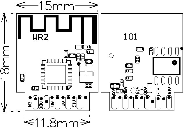

WR2 has a total of 2 rows of pins (2×9), and the pin spacing is 1.5mm.
WR2 size: 15 mm (W) × 18 mm (L) × 3.3 mm (H), the package is shown in Figure 2.1:
​ Figure 2.1 WR2 Dimensional Drawing

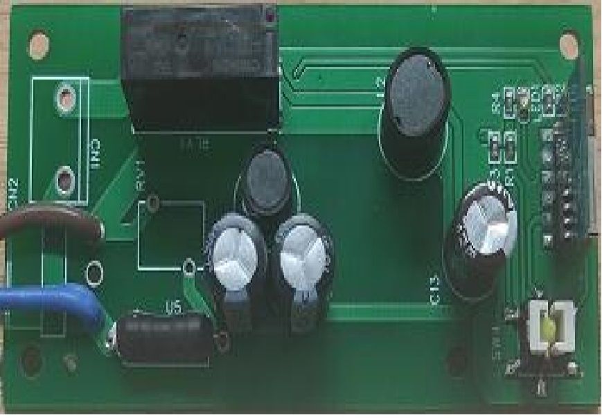

After welding the power supply part, conduct a power test first. The success or failure depends entirely on the power supply. As a result, something went wrong. The power chip exploded when I turned on the power. I checked the schematic and found the problem. I was really careless and lost more than 4 yuan...
The board can only jump wires now. Everyone in the group is worried about jumpers. I am secretly happy that mine can't jump wires. All right. . Before jumping the wires, change the schematic diagram first. You can compare it with the above schematic diagram to see the problem. .
After the PCB jumper is powered on, the 5V output and 3.3V output voltages are normal. Look at the devastated board
The voltage is normal, let's start welding the module.
Pictures after welding the module
A power supply casing is installed. The WIFI indicator light uses the original light guide pillar of the power supply casing. I mark a hole for the button and use a glue stick to make a button. It can also guide light and can be pressed, killing two birds with one stone.
