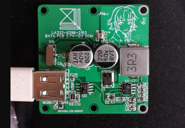

Input voltage 2.7V-12V, output voltage up to 12V (the SEL pin is left floating, the protocol chip data sheet indicates that if it is left floating, the maximum voltage is limited to 12V, the boost chip itself is up to 13V), maximum input current 10A, with indicator light display and switch Can control whether the boost chip works or not. The module has been successfully verified.
