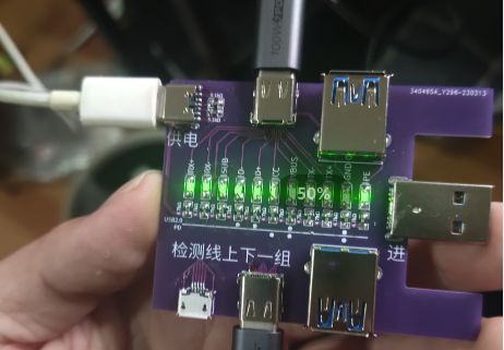

USB data cable test and detection (simple)
Obtain 5V power supply, connect to the resistor LED and then go to the output signal port.
Because Xingkun in Lichuang Mall has coupons with full discounts, this power supply interface uses (C2764612) and
only measured 11 USB3.0 8 USB+CC+SUB+shielding
One of the typeC ports is not very easy to solder. Avoid short circuit and false soldering between the two.
TypeC (C388659)
and typeA (C2880600)
have simple input. Because they are all connected to GND, they do not need to be soldered. A short circuit with tin will not affect it. (When testing, please ensure that the data cable is only connected to this tool)
typeA (male) (C2684720)
Micro-B (C319160) Data cables with chips
are sent to female C and A.
As long as they touch the shield, three LEDs will light up. This was discovered by accident.
