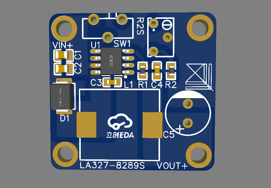

Input voltage 5.5V to 36V
Output voltage 1.46V to 25.2V
Input and output current does not exceed 5A
The potentiometer controls the output voltage. The schematic diagram contains the calculation formula and the reference resistor drawn by me. If the potentiometer resistance is 0, the output is 1.46V, and the maximum is 25.2V.
