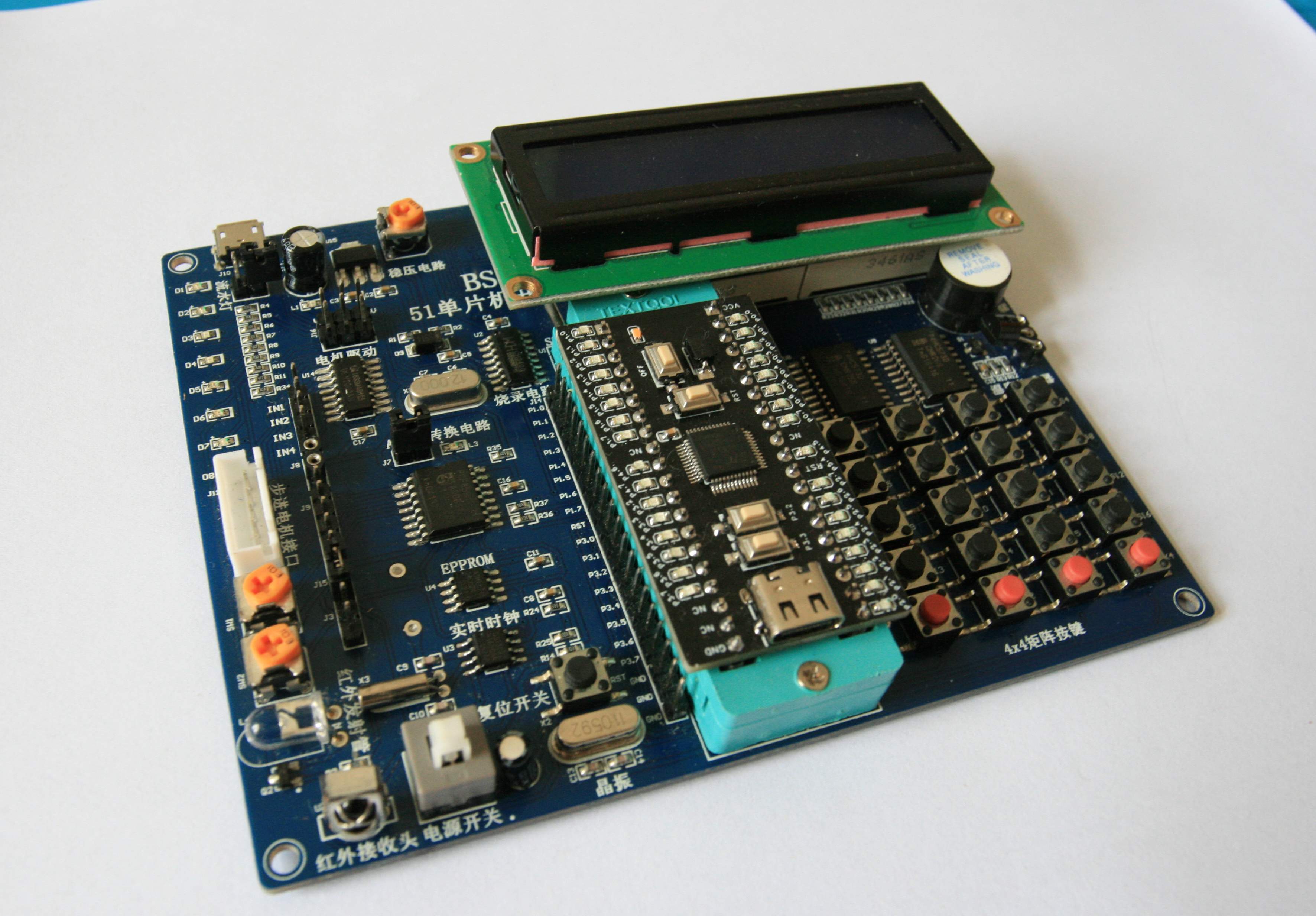

The pin sequence of the development board is compatible with the common 8051 core boards on the market. Some sample codes are written by Keil5-C251. Please see the attachment for details.
Progress: 2022.07.08 V1.0 completed PCB-DFM
2022.07.18 V1.0 has been board tested and the STC32G12K128 works normally
2022.08.13 V1.0 Upload part of the code and complete open source

Modified with the official "Dragon Subduing Stick":
1. Replace the power-off transistor and anti-reverse diode models. In most cases, manual reset is not required. If there is too much load, you may need to manually press the power-off button;
2. Replace JP1 with an NC resistor. Please short-circuit this pin if you need to use it;
3. Optimize some wiring to reduce interference;
4. Use existing standard library components to reduce SMT costs.
Project pictures
Effect of accessing the expansion board:
The effect of connecting the automatic downloader (no cold start):
Digital tube static display:
LCD1602 displays:
