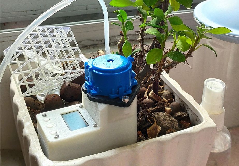

Developed based on Arduino IDE, using Atmega328p-AU chip
* I used kicad to draw before. Since the latest version of kicad cannot import files, only the schematic diagram is provided for the time being (lccad-pcb is too difficult to draw 2333). The source code, board file and 3D printing shell can be downloaded from Code Cloud.
* The LDO version has been successfully verified and the shell suitable for 3D printing has been uploaded
* Watch the demo video: https://www.bilibili.com/video/BV1UV411b7vG
* All TB connections are ad-free and purely useful if you think they are useful
* Sleep time unit is hours
* Water according to the soil moisture threshold you set, rather than simply watering regularly to avoid unnecessary watering.
* Automatically enters sleep when there is no watering task to save power. The dormant current is 0.6ma, which can be charged once every few weeks (small flower pots). With the solar charger, it can achieve long-term unsupervised supervision.
* MX612E motor driver chip supports PWM adjustment of water pump speed, with overheating and power-off protection.
* The combined structure of the main control PCB + capacitive soil moisture detection PCB, the main control integrates the soil moisture drive circuit, the sensor can be flying wires, or can be welded to the main control board from the side to achieve higher integration.

* The main control board does not have a battery low-voltage protection circuit. Over-discharge of the battery will cause the battery life to decrease. Please use a battery with a protection board and do not let the battery voltage fall below 3.0V.
* It is recommended to calibrate the reference voltage for first time use so that the power display is more accurate. The power supply voltage for measuring the screen is the reference voltage.
* Using a battery with a low discharge rate may cause the overcurrent protection of the battery protection board to be triggered and power outage when the water pump is started. Turning on the smooth start function of the water pump can improve this phenomenon. The reason is that the starting current of some water pumps is too high, causing the protection to be triggered and smooth. Start can reduce the starting current of the water pump.
* When using a 6V peristaltic pump (NKP-DC-S10B) , the larger the pipe diameter, the greater the water output. It is recommended to use a silicone tube with an outer diameter of 5mm and an inner diameter of 3mm.
* The water outlet should not be too far away from the soil moisture sensor. If the humidity is too far away, slow transmission of humidity will cause the flowerpot to overflow with water.
The watering speed cannot be too fast. You can adjust the watering speed by adjusting PWM MAX. If it is too fast, only the soil near the sensor will be wet.
* If you want to pursue perfect watering effect, you need to bury the soil moisture sensor horizontally at the bottom of the flower pot and take waterproof measures for the sensor.
* Use 4 M2x12 screws to fix the cover, and 2 M3x8 screws to fix the water pump.
