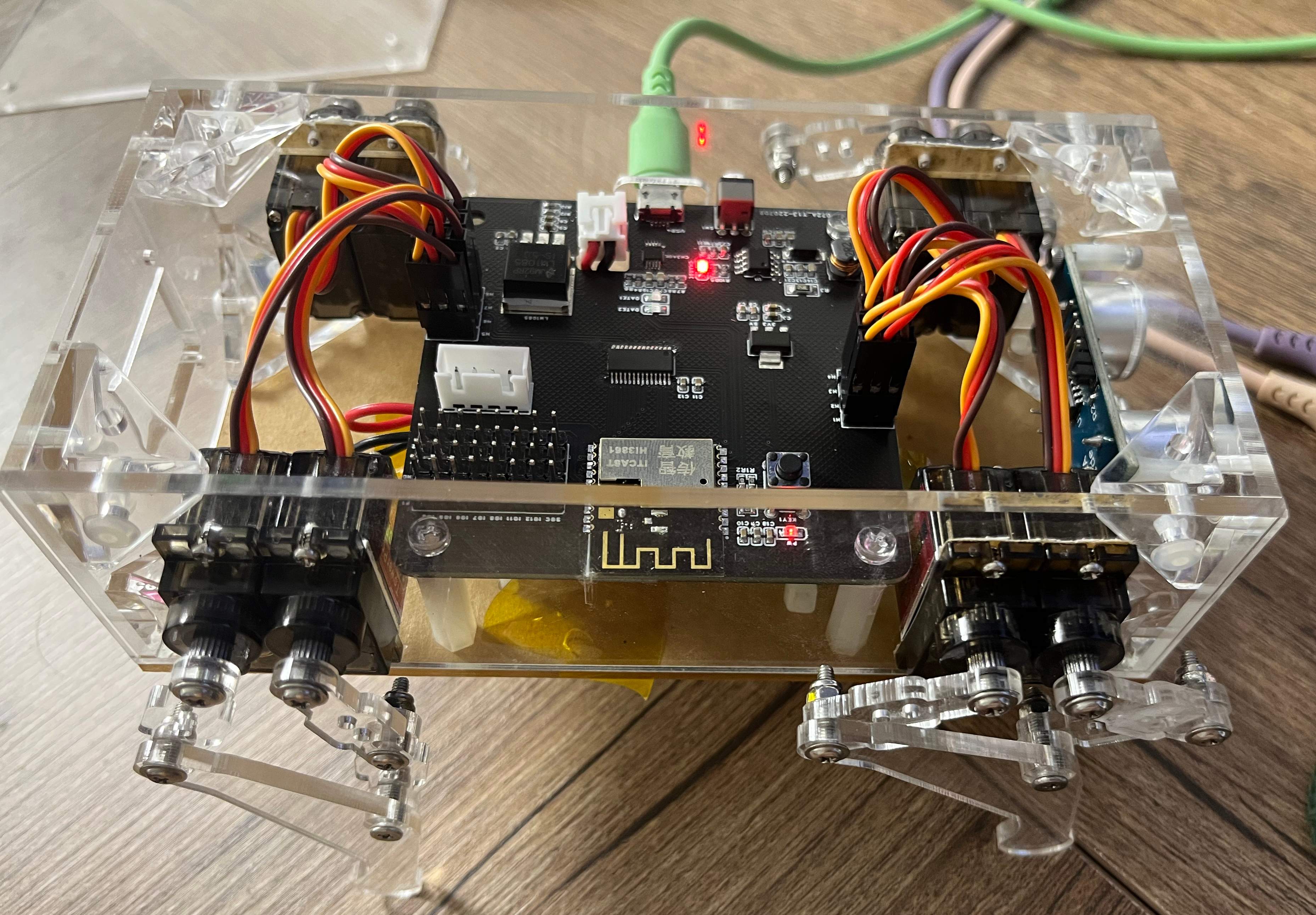

Structural design:
Acrylic plates are cut and customized, and 8 corner codes are used to fix each layer. Each leg is fixed with M2.5*12 and M2.5*14 bolts. The corner codes are fixed with 3mm inner diameter transparent hidden buckles (the bolts will interfere, And it is inconvenient to disassemble and assemble). The non-stressed moving parts are fixed with M3*8 transparent acrylic bolts.
Current features:
1. Basic sports posture functions
2. Battery charging function
Subsequent planned expansion part (interfaces have been reserved):
1. The OLED screen displays battery SOC/temperature and humidity/ultrasonic ranging and other information
2. Add gesture sensor module
3. Add temperature control fan
