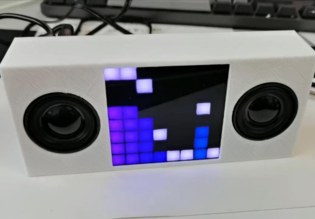

This design draws on: (1) SOP16 packaged audio power amplifier solution verification board solution; (2) Chai Gong speaker solution (https://oshwhub.com/winton/d-lei-shuo-zi-gong-fang); (3) Desktop pixel audio lamp from Bilibili Up’s Master Creation Project;
(1) The core part of the project refers to the project of Chai Gong. https://oshwhub.com/winton/d-lei-shuo-zi-gong-fang
Deleted the 2-way LED indicators in the original project
(2)The audio chip uses EG8405
(3) Drawing on the desktop pixel audio lamp from the master creator plan of B site up, the Arduino mini pro module and the 8X8 WS2812B module are added to form a rhythm module, which can be used in conjunction with the audio to display colorful rhythms.
*2. Project attributes
For the original project, please refer to https://oshwhub.com/winton/d-lei-shuo-zi-gong-fang
This project refers to other people's projects and improves them according to my own actual situation. This is the first time to participate.
* 3. Open source agreement
GPL3.0
Please fill in during the competition stage↓
*4. Hardware part
The power chip uses EG8405.
Rhythm spectrum identification uses the Arduino mini pro 5V version.
The 8x8 LED matrix is ​​a WS2812B matrix board.
The Bluetooth module uses M18 Bluetooth audio module.
The speaker requires an external 5V DC power supply.
Note: The second version of the PCB changes the power and audio interfaces to 2.54mm pin headers for easy plugging.
*5. Software part
See project attachments for details
The FFT function is used for spectrum identification.
