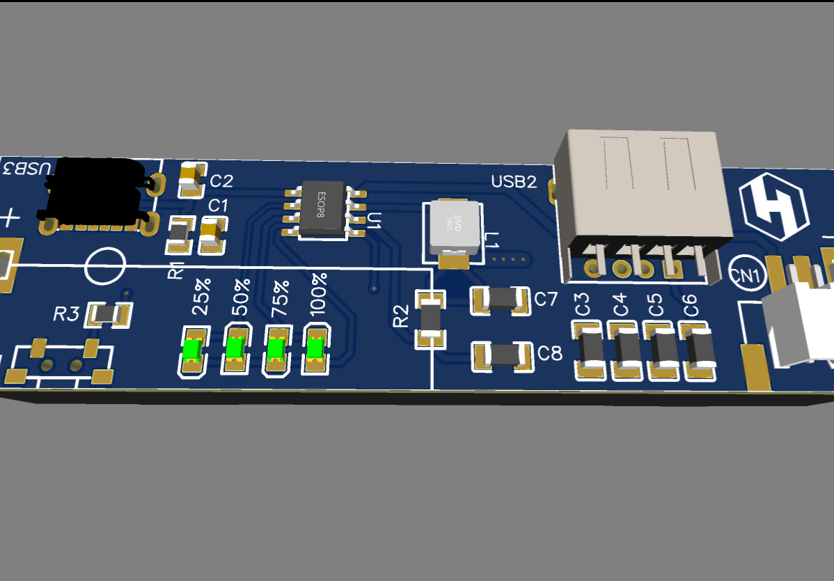

The IP5306+18650 module drawn according to the circuit description has 4LED power display and a 5V output with a maximum output current of 2.4A. Use the TYPE-C interface for charging and the USB-A+2P terminal interface for discharge. It is mainly used for daily experimental purposes, and a 2.54 2P connector is added to facilitate access to other equipment for debugging. PS: If necessary, you can also connect a plug to the battery output end separately, which is suitable for large current situations.
PS: It has been corrected and can be played.
