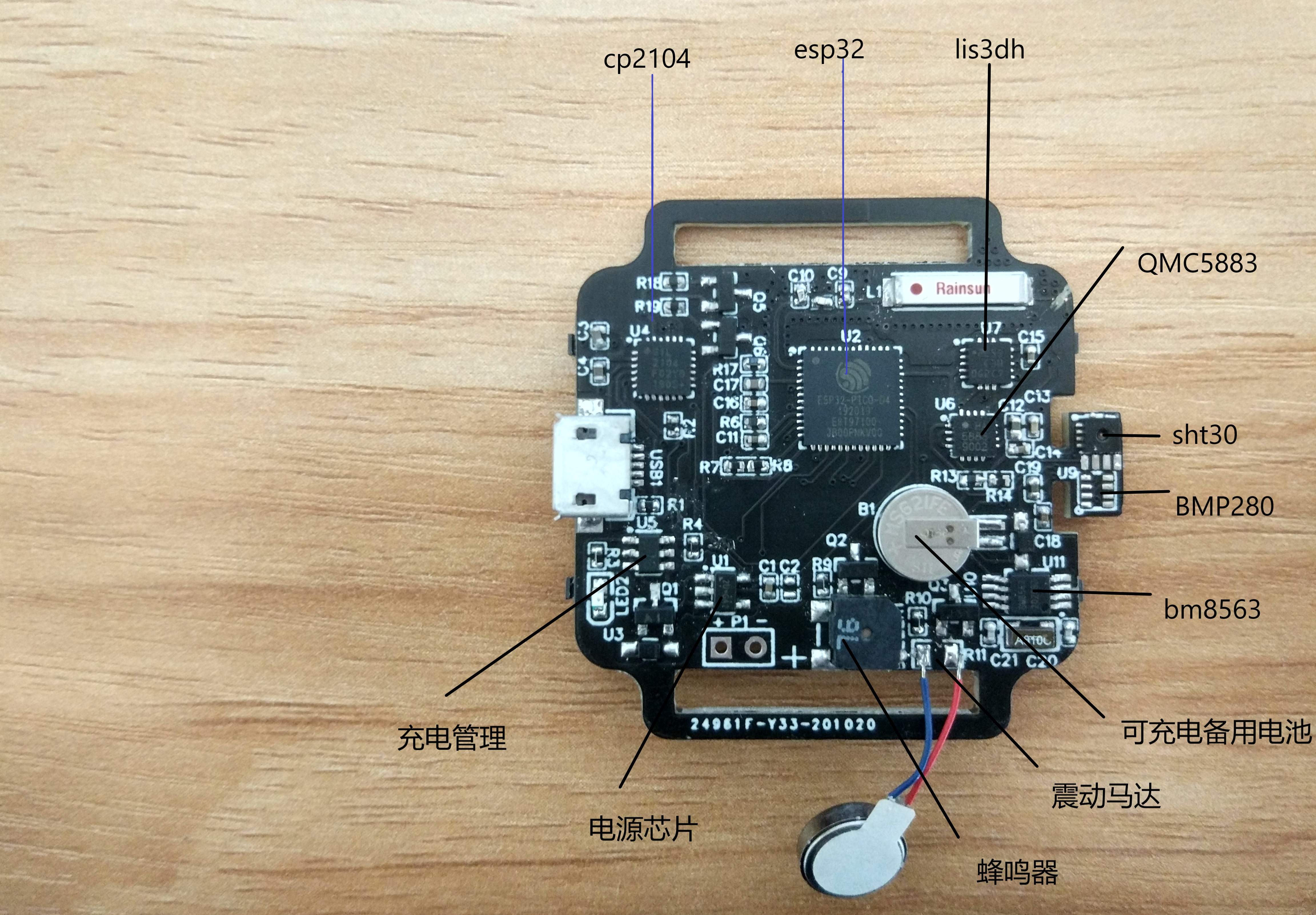

  • esp32-d4-pico integrates 4MB of flash, wifi, and Bluetooth
  • real time clock bm8530
  • Temperature and humidity sht30 (BMP280 optional)
  • Three-axis geomagnetic HMC5883
  • Three-axis acceleration LIS3DH
  • Micro vibration motor
  • SMD buzzer
  • 200mah battery
  • cp2104 realizes communication between computer usb and watch
