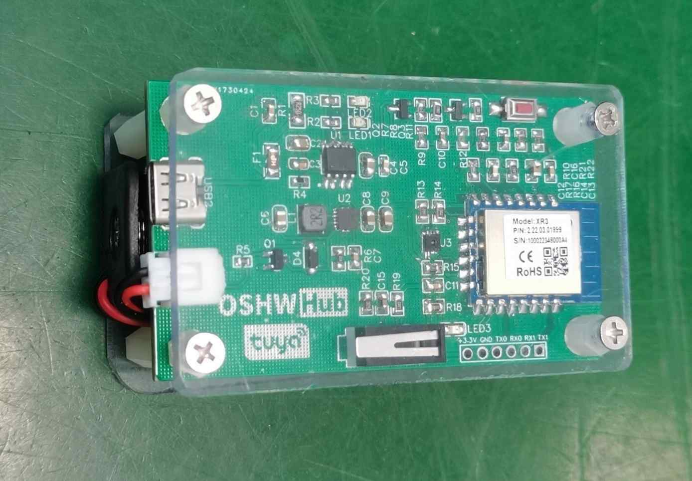

Design:
1.SHT30 temperature and humidity collection;
2. Tuya XR3 WIFI module uploads to Tuya Cloud;
3. Use TPS63001 (1.8~5.5V) to step up and down to 3.3V to ensure that the module can work normally when the battery is lower than 3.3V;
4. USB power supply and 3.7V-4.2V battery power supply (this case uses a single 18650 power supply). When the USB is inserted, the battery is charging and the power supply switches to USB power supply;
5. Use the public version of the app to check temperature, humidity and battery power, with a low battery warning function;
6. Use the upper protective cover to press the micro switch. When the protective cover is removed, the app will alarm.

Physical and APP display pictures:
