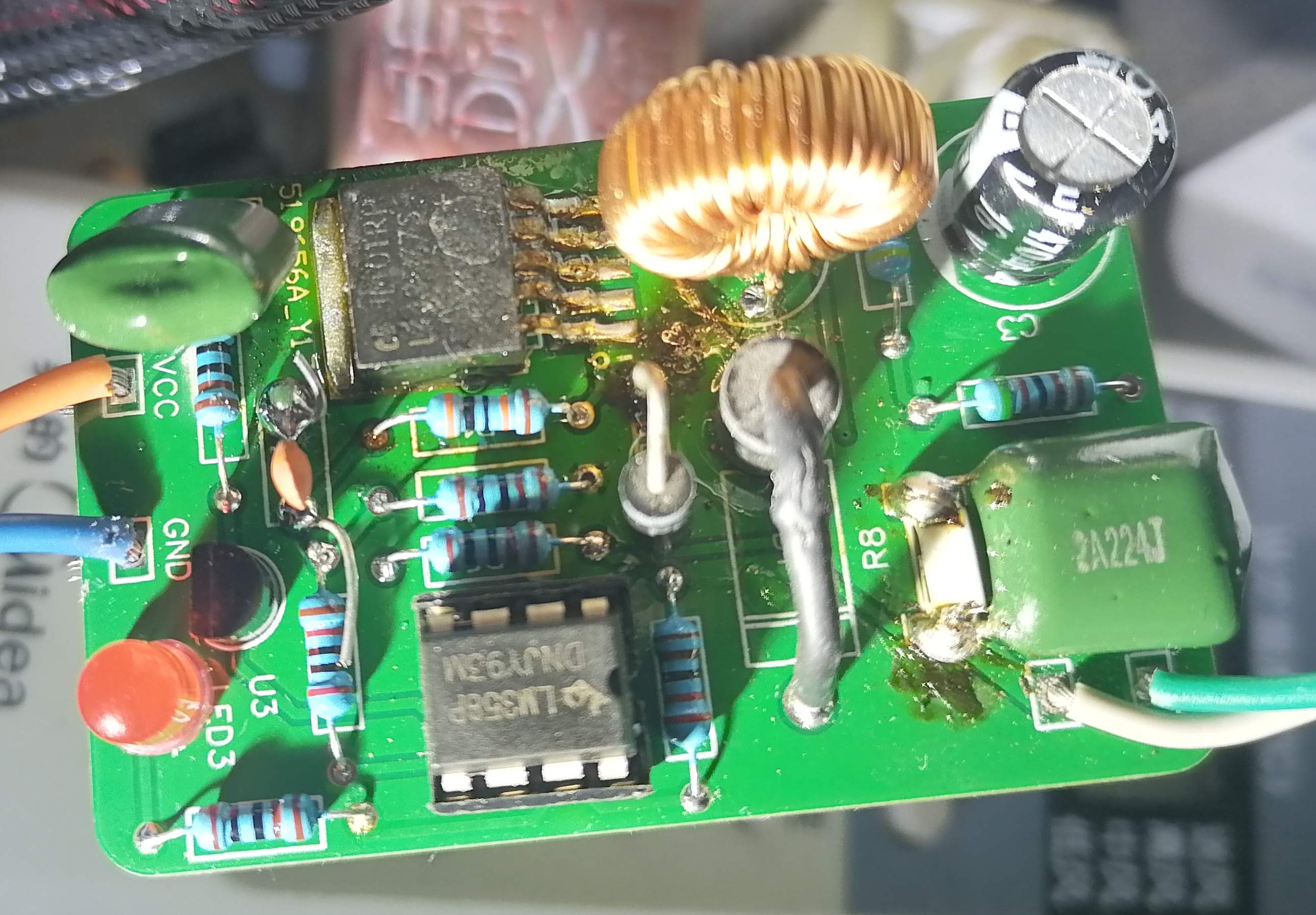

The experiment has been successful. 5v input 12.6v constant current 300ma. The sampling resistor can be set by yourself. The feedback voltage dividing resistor can also be set by yourself to achieve different output voltages and currents.
