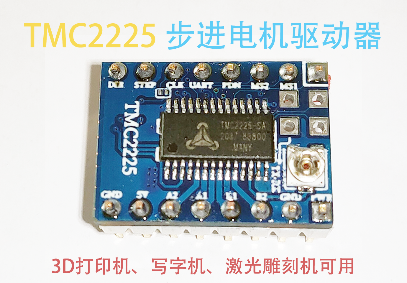

[20201005 Update] TMC2225 stepper motor driver-double-layer board
(October 5, 2020, 03:11) The coil current sampling resistor package was replaced, and 0603 was replaced with a higher power 1206; all components except the TMC2225 chip and patch potentiometer were placed on the bottom layer; the wiring was re-wired , thicken the coil current sampling resistor trace to a reasonable width
