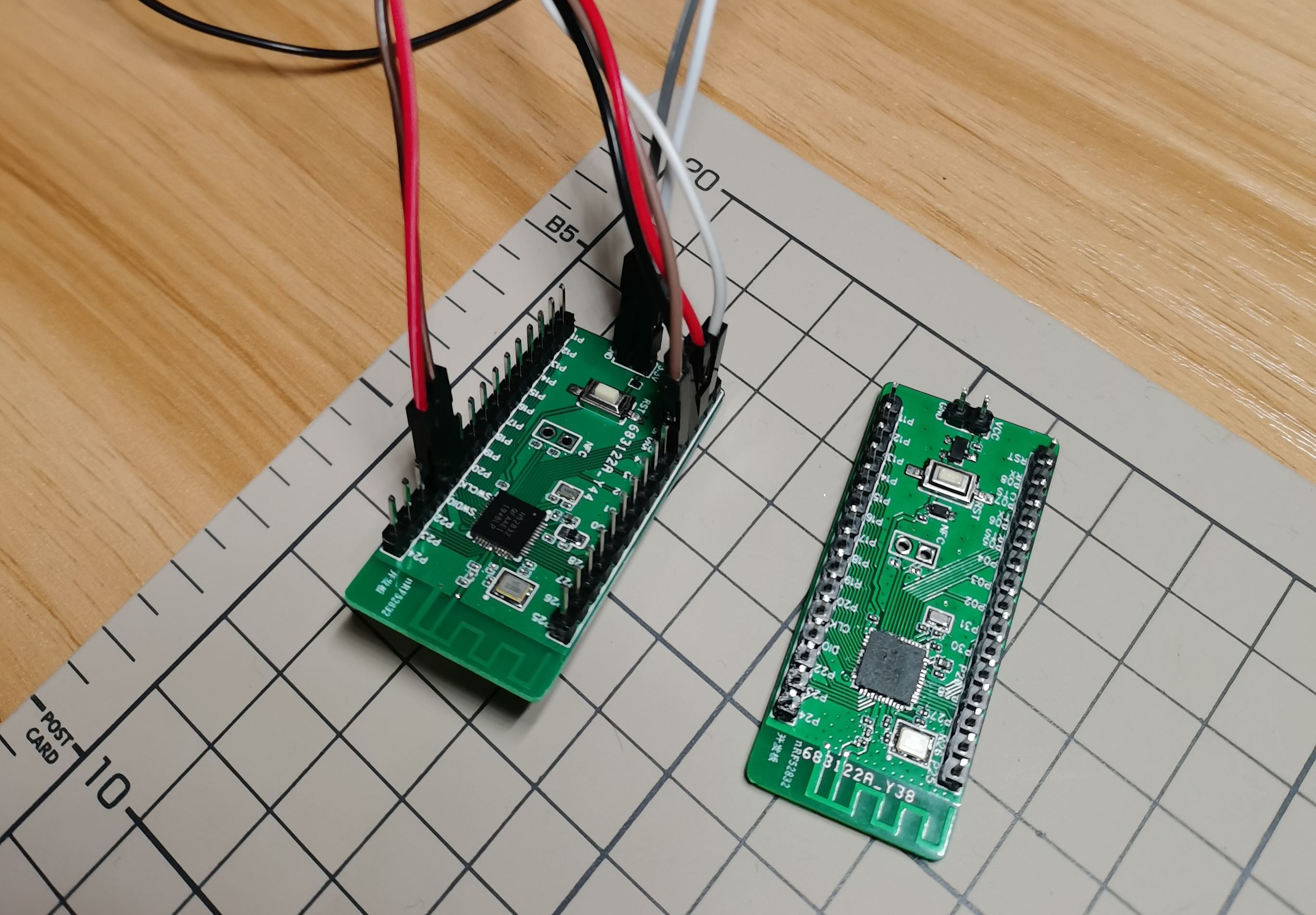

It is divided into two versions: c is the LDO power supply version, d is the internal DC-DC power supply version (recommended), and d is more power-saving.
The nfc antenna has not been tested, and JLINK v9 is used for programming and debugging.

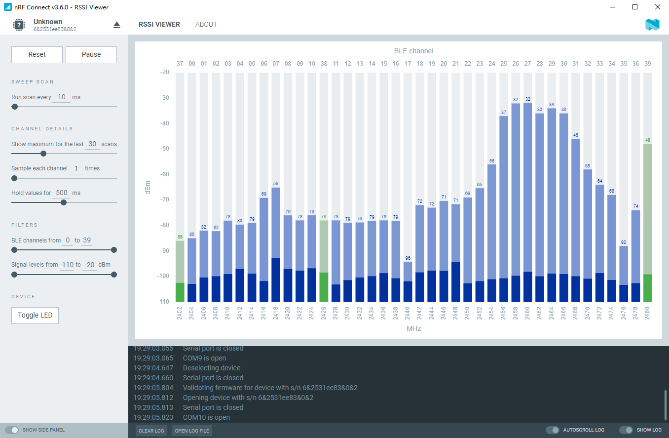

The picture below is the signal measured using official tools.

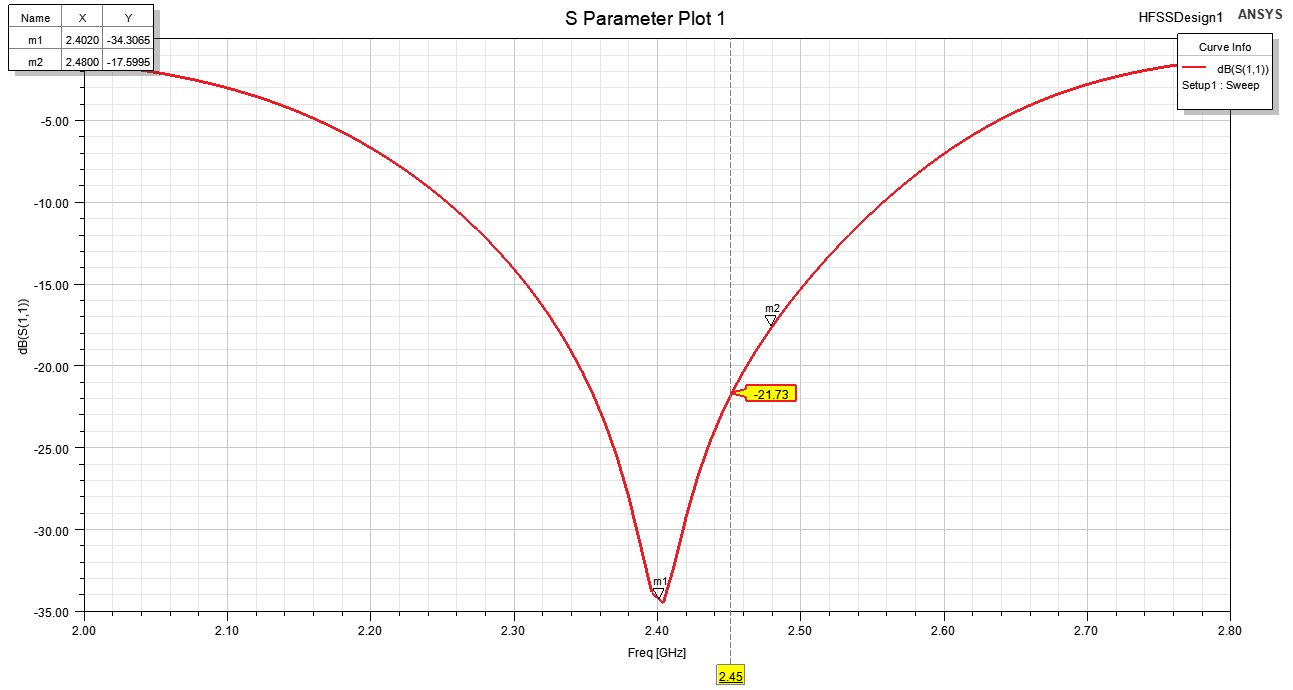

The picture below is the simulated S11.
