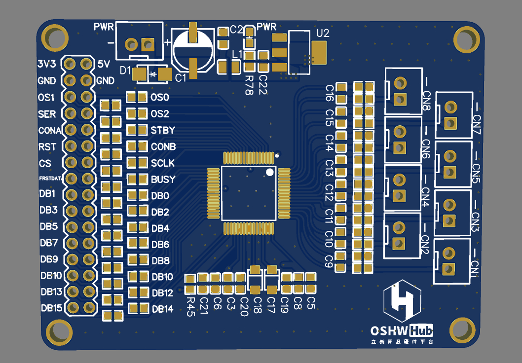

  • This project is used to verify the solution verification board design of the AD7606BSTZ-RL analog -to-digital conversion chip of Lichuang Mall
  • This project is a sample project for the Solicitation Order for Lichuang EDA Open Source Hardware Platform Solution Verification Module
  • This design is an analog-to-digital conversion module based on AD7606. AD7606 is an 8-channel 16-bit serial and parallel output analog-to-digital conversion chip.
  • This design builds the peripheral circuits of the chip, including power circuits, pull-up and pull-down circuits, etc., and leads out all control pins and data pins to facilitate connection with the microcontroller.
  • The next step will be to conduct PCB proofing, and then update PCB photos, soldering finished product photos, etc.
  • During DRC inspection, be sure to change the hole to an inner diameter of 0.3mm and an outer diameter of 0.6mm.
参考设计图片
