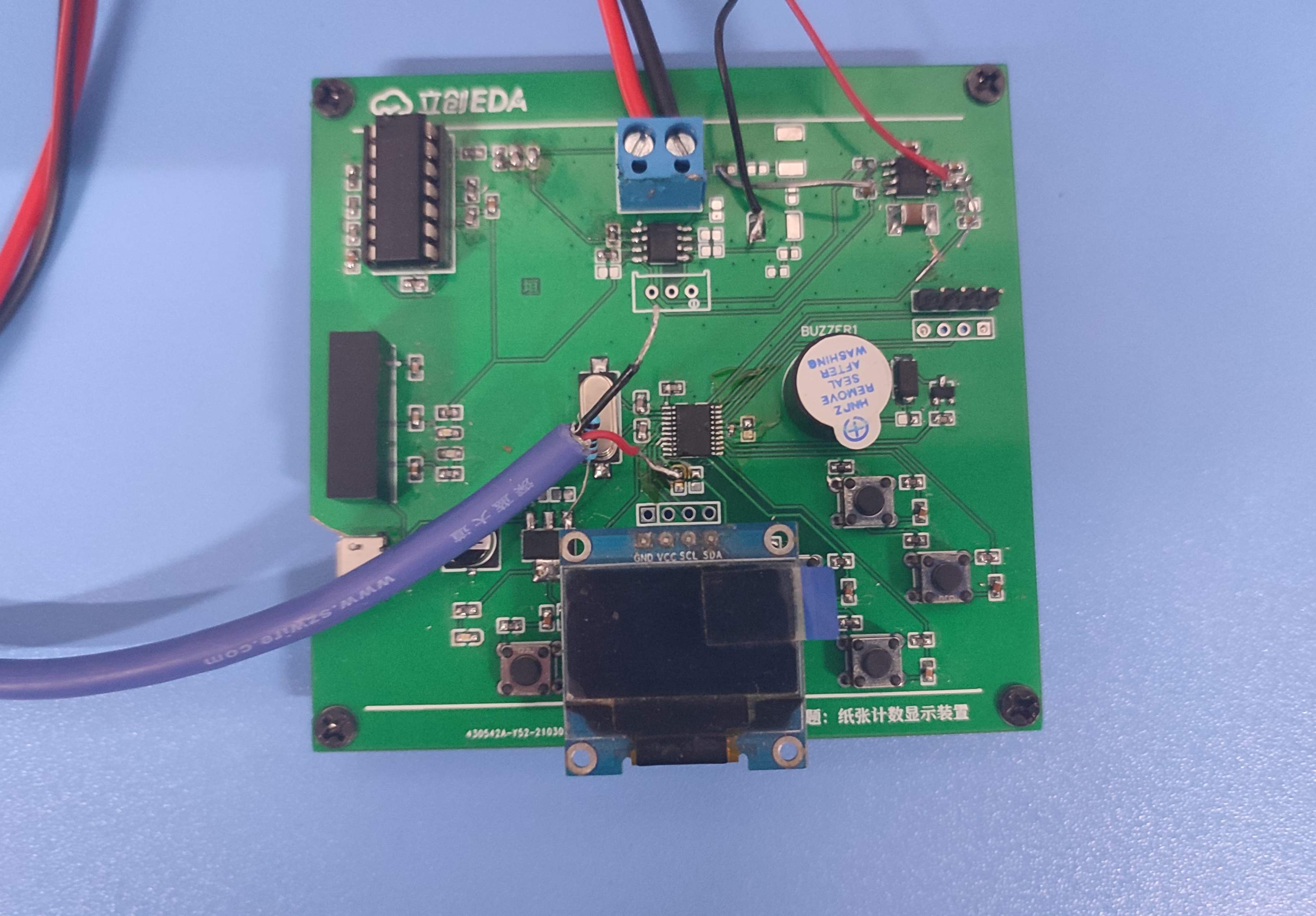

4. Physical picture display
Physical mapThe soldering flying wire is an AC signal wire; the red thin flying wire is a DC signal wire (the original IO for detecting AD was burned out, so I replaced it); the black thin flying wire is useless.
5. Debugging process
      1) The first step is to debug the output of the positive wave generating circuit. Its output amplitude depends on the power supply voltage of the subsequent operational amplifier (generally around 0.05~0.1), and the frequency is preferably greater than 100khz;
      2) Debugging the detection circuit. Select the size of capacitor C0 (reference capacitor). The principle is to make the output voltage equal to the maximum reliable output voltage when the number of sheets of paper is 30, in order to obtain the maximum resolution (the amount of output voltage change consisting of a single sheet of paper). If conditions permit, you can first measure the size of the plate (one side is about 200pf), and then select according to the actual circuit;
      3) Adjust the filter circuit. (Basically no problem) Its purpose is to filter out the interference of power frequency signals;
      4) Debug the peak detection circuit to achieve the minimum error. If conditions permit, it is recommended to use the effective value detection circuit, and its accuracy will be greatly improved.
      5) Debugging the program. It is relatively simple and can be written according to your own habits, mainly for ADC detection problems.
