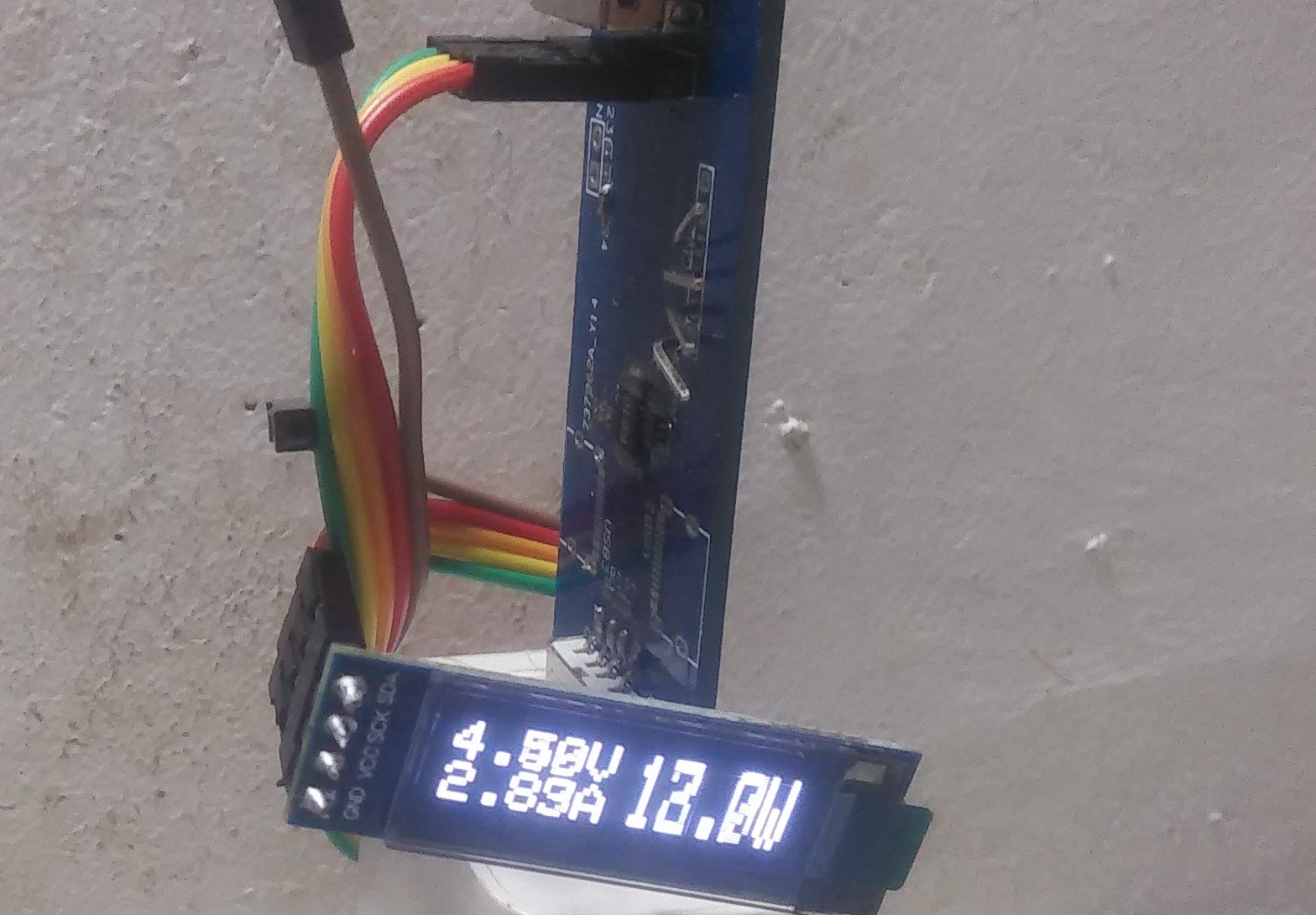

* 1. Project Function Introduction
Measure the voltage and current flowing through the USB

*4. The hardware part
is developed using the MCU of National Technology, supports PD fast charging, and is divided into two versions: 5-20V and 12-26V. Please pay attention to the packaging and withstand voltage value of the capacitor for user convenience.
Note: It is recommended to use Jiali Chuang EDA. If you choose other EDA tools, please upload the schematic diagram in PDF format, the PCB drawing in PDF format, and the PCB file in Gerber format in the attachment. Here you can explain in detail the implementation principle and mechanism of your project, precautions, debugging methods, testing methods, etc. It is recommended to introduce your ideas to others in the form of pictures and texts.
*5. The software part
is developed using keil, and supports downloading via J-link, ST-link, serial port, etc.
Note: If your project involves software development, please upload the corresponding engineering source code in the attachment. Here you can explain in detail your software flow chart, functional module block diagram, explanation or popularization of related algorithms, source code structure, compilation environment construction and configuration, source code compilation method, program burning method, etc. It is recommended to introduce your ideas to others in the form of pictures and texts. *6, Please enter the content
of BOM list ... 0.1u C1,C4,C21,C22,C23 C0603 5 100u C2,C3,C16 C0603 3 4.7u C18,C19,C20 C0603 3 Burn CN2 HDR-TH_6P-P2.00-VM 1 0.91LCD H1 HDR-TH_4P-P2.54-VM 1 1 H2 HDR-TH_2P-P2.54-VM-1 1 2 H3 HDR-TH_2P-P2.54-VM-1 1 0.01 R1 R2512 1 90k R2 R0603 1 10k R3,R4,R5 R0603 3 Male U2 USB-A-SMD_USB-07 1 N32G430C8L7 U3 LQFP-48_L7.0-W7.0-P0.50-LS9.0-BL 1 AMS1117-3.3V U4 SOT-223-4_L6.5-W3.5-P2.30-LS7.0-BR 1 LM78L12 U6 TO-92-3_L4.9-W3.7-P1.27-L 1 INA199A1DCKR U7 SC-70-6_L2.2-W1.3-P0.65-LS2.1-BR 1 KH-TYPE-C-16P USB2,USB3 USB-C-SMD_KH-TYPE-C-16P 2 female USB4 USB-A-TH_USB-302-T 1 Note: The BOM list involved in the project. Please upload a screenshot of the BOM in this location. Please upload the list details in the attachment in PDF format. It is recommended to include model, brand, name, package, procurement channel, purpose and other content. The specific content and form should be based on the clear expression of the project composition. *7. For the competition LOGO verification, please upload the project picture containing the competition logo, and the logo is printed on the PCB in the form of silk screen. Click zip to download the competition logo! (Competition logo).zip * 8. Demonstrate your project and record it into a video. Video upload requirements: Please shoot horizontally, with a resolution of not less than 1280×720, in Mp4/Mov format, and a single video size limited to 100M; video title: Lichuang Electric Competition: {Project Name}-{Video Module Name}; such as Lichuang Electric Competition: "Autonomous Driving"-Team Introduction.
