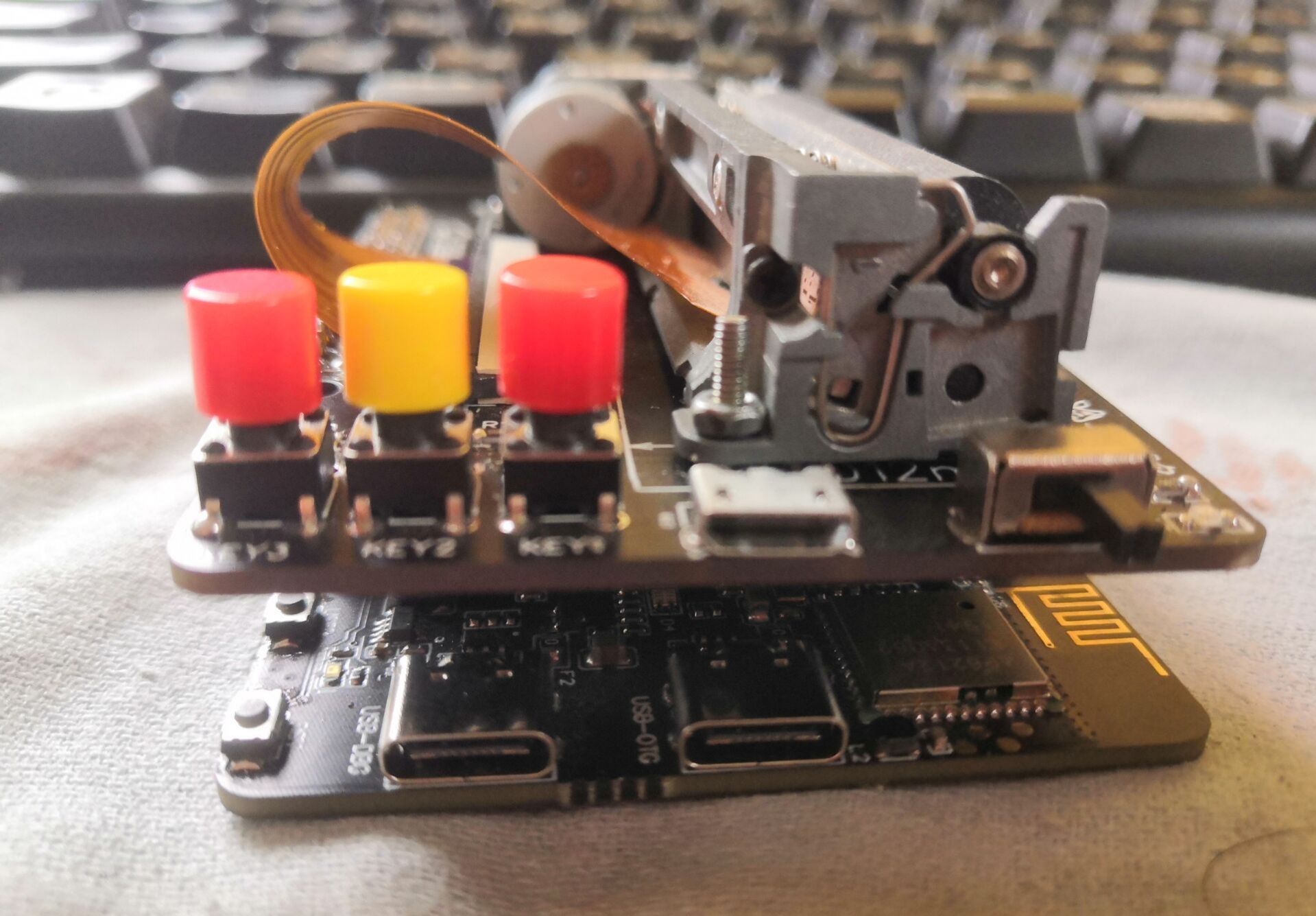

3. Display diagram of ART_PI and expansion board

Printer driver migration
Briefly introduce the pins of the printer. 4 pins control the operation of the motor, 6 pins are responsible for heating, one pin LAT is responsible for latching data (to put it bluntly, it is chip select), one SCK, and one DI (can form an SPI). , you only need to configure 4 click pins and 6 heating pins as PIN outputs, LAT, SCK and DI to configure an SPI device to transmit data, so it can be driven.
Regarding the issues required during the configuration process, I configured the SPI2 driver from CubeMX as usual, and then transplanted it to the board.c file. I also enabled SPI2, and the SPI20 device was also recognized in the console, but the final result It means that SPI transmission failed. I was delayed at this step for a long time, doing various tests, looking for errors, and even tested it with a logic analyzer. There were no waveforms at all, and I had no clue. Finally, after reading the online documentation, I realized that I was wrong from the beginning. (It would not be unfair to say that I am a pig.) For a project created based on the development board, it is useless for us to add the transplanted driver in board.c. We need to
To configure this file, I opened this file and found the SPI initialization, which contains SPI1 and SPI4 drivers. This also explains why my first step W25Q128 can drive successfully, but my SPI2 fails to transmit data. After I transplanted the SPI2 program image.png
Sure enough, the transmission was normal.
Test motor rotation: To test motor rotation, you only need to make 4 pins output levels in sequence, that is, drive the stepper motor. I wrote a rotation test,
/* 测试打印机转动 */
void testPrinterRight(void)
    rt_uint16_t i;
      for(i = 0;i < 40; i++)
          printer_right(50,2);
      rt_kprintf("testPrinterRight success
MSH_CMD_EXPORT(testPrinterRight,testPrinterRight);
Just enter testPrinterRight on the command line and the motor will rotate a certain distance.
Then write the program for printing Chinese characters, letters, and the program for printing pictures. After unremitting efforts, the first stage is completed.
Attach the renderings: image.pngimage.png
