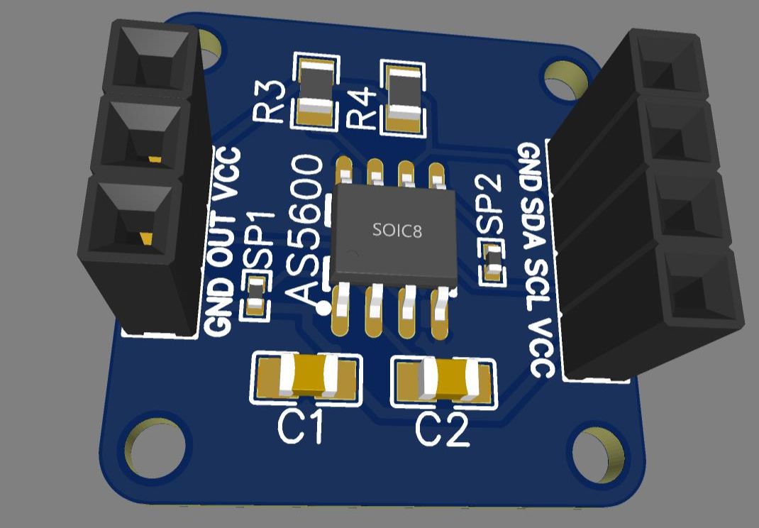

The pin design of the commercially available As5600 module is not reasonable and the wiring is very troublesome. Therefore, it was improved to a set of I2C and a set of three-wire interfaces. The frame was reduced to 20x20mm, the mounting holes were 2mm, and the spacing was compatible with the original design of 16x16mm. There are also two pad jumpers JS1/JS2 to set the 5v/3.3v power supply and output mode selection Pwm/I2C. The default is 5v and I2C.
