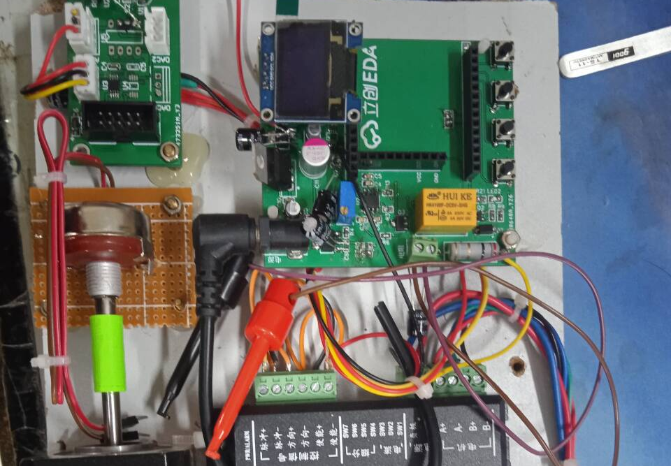

2. Overall system design and parameter calculation
The system block diagram of the instrument system is shown in Figure 3. It consists of a resistance measurement circuit, A/D converter, microcontroller system, stepper motor drive and other parts. The resistance measurement circuit is the most critical part of the instrument. The microcontroller performs gear shifting operations by controlling the relay, and collects the voltage of the divided voltage measurement circuit by controlling the A/D converter to complete the electrical measurement function. The microcontroller completes the automatic measurement function of the potentiometer resistance by controlling the stepper motor and cooperating with the resistance measurement.

3. Circuit design
1. Constant current circuit
R1 is a positioner to adjust the current.
2. Voltage dividing circuit
The normally closed terminal of the relay is connected to a 1K resistor, and VCC is powered by 3.3V .
3. Resistor voltage sampling circuit
The acquisition circuit is a 16 -bit ADS8320 external voltage follower

3. Locator automatic scanning mode flow chart
The scanning program mainly drives the positioner through a stepper motor, and then displays the curve of the resistance angle change of the positioner in real time on the OLED LCD screen, using the dot method.
