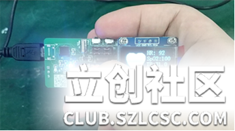

. Introduction of the project
        With the improvement of the quality of life and the acceleration of the pace of life, people need to pay more attention to their health. This project aims to design a body parameter testing system based on cloud platform + APP + device side, using pulse sensor, infrared sensor, weak signal detection circuit, etc. to realize the collection of human body parameters, and upload the data to the cloud storage through wireless network or other means, and provide a web-side interactive interface to build a human body parameter management platform for users.

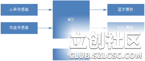

2. System architecture diagram
        The hardware part of the system consists of MCU, heart rate sensor, temperature sensor, power supply, Bluetooth module, and WiFi module. The software part includes stm32 program design based on C language, upper computer software design, server-side web page and background program design, and APP software design. The hardware architecture and software architecture are shown in the following figures respectively.
        When the system is working, the original AD signals of heart rate and body temperature are collected by heart rate sensor and temperature sensor respectively, and the heart rate and temperature values ​​are calculated by corresponding algorithms, and uploaded to the cloud server through WiFi. The cloud server processes, stores and analyzes the transmitted data, and also issues warnings and prompts through data analysis. Users only need to log in to the corresponding webpage or mobile phone APP to view the real-time and historical data of themselves or their families. In addition, this system also provides a positioning function, and users can view the location of the measurement terminal on the map.

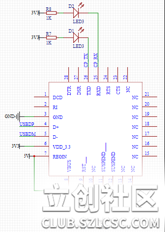

2. USB to serial port circuit
        Using USB as the system program download interface, its level needs to be converted to communicate with the serial port of STM32. This system uses CP2102 as the conversion chip. CP2102 has high integration, built-in USB2.0 full-speed function controller, USB transceiver, crystal oscillator, EEPROM and asynchronous serial data bus (UART), supports full-function modem signals, and does not require any external USB devices. The working principle of CP2102 is similar to that of other USB-UART conversion circuits. The driver program virtualizes the USB port of the PC into a COM port to achieve the purpose of expansion. The circuit design diagram of this part is shown in the figure.

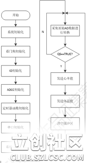

1. Main chip program design
    STM32 program design is based on RT-Thread line development. In addition to system initialization, in the main program, the following functions are completed:
        1) Collect the AD data of the sensor through the internal AD interface;
        2) Process the data through the algorithm;
        3) Pack the processed data and provide the WiFi module to send it to the server;
        4) Feed the dog. According to the above 4 functions, the program workflow diagram is shown in the figure.

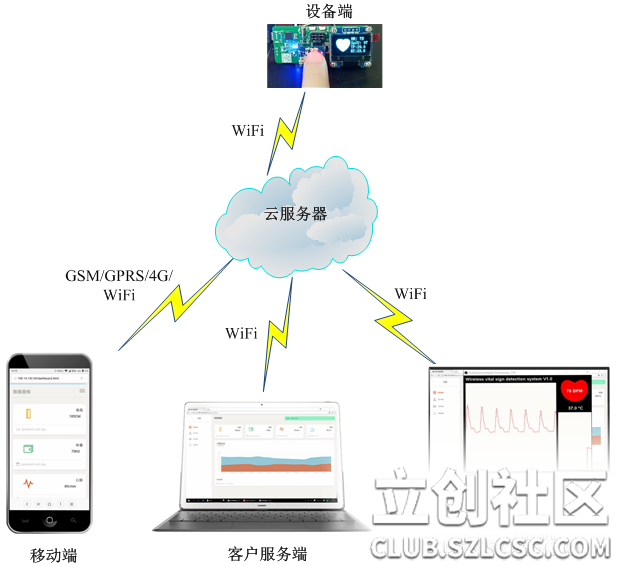

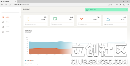

3. Server software and web design

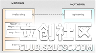

        The server side uses the cloud server provided by Alibaba Cloud, and its data transmission protocol is the MQTT protocol. The measurement acquisition end is the device end of MQTT, and the cloud server is the server end of MQTT. The received data is stored in SQL and displayed through the web page. The MQTT protocol data transmission process is shown in the figure.
        The designed main data interface is shown in Figure
4. APP software design
      After the mobile terminal APP is opened for the first time, manual network configuration is performed. When the specified WIFI signal is searched, it is connected, and then the TCP port is monitored, the received data packets are parsed, and then the data is displayed on the screen. The designed APP is shown in the figure below.
