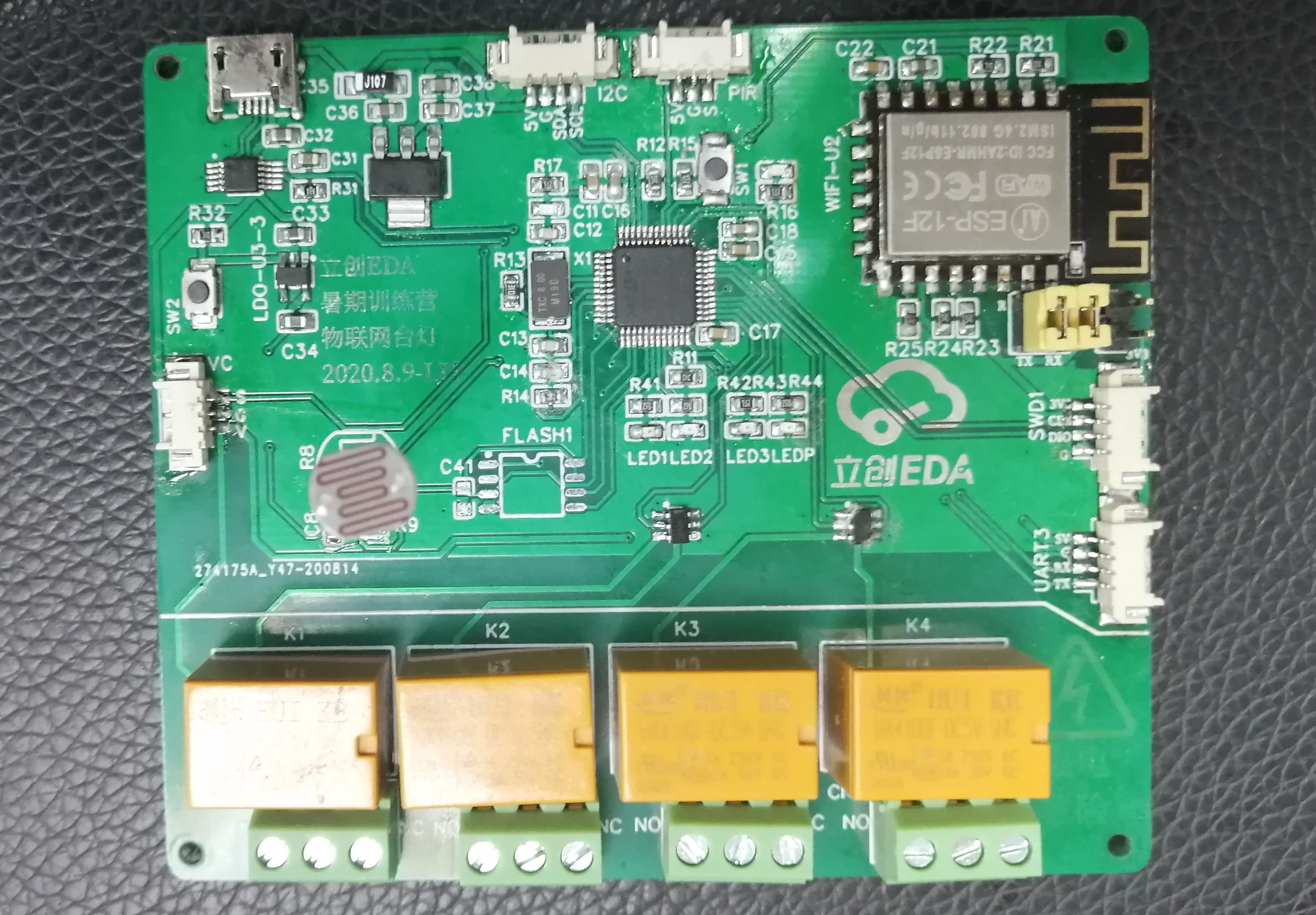

First is the hardware. The boards made at Jiali Chuang are empty boards (five boards for five yuan are shipped in 24 hours, which is really cool). The main reason is that there are not many components, and the empty boards are quick to make and easy to debug. When I first learned how to draw a board, I was always very confident and felt that everything would run away as soon as I soldered it. However, there were basically a lot of problems and it was not easy to find them. Therefore, I developed a habit later on, dividing the designed board into multiple modules according to functions, welding them one by one and debugging them one by one, and then moved on to the next part after they were ok. This project divides the board into the following modules, and the debugging sequence is: power supply, MCU, WIFI, relays, and other external sensors and modules. The former is the basis for the latter, that is, only when the power supply is normal can other modules work. Only after the MCU, as the system brain, works normally can the remaining modules be connected together to play a role. WIFI and relays, as the core parts of this project, must be ok under the premise that everything above is ok. Debugging, while other modules such as sound, light, temperature and humidity OLED will be debugged later as increments. Next is software debugging. The software idea is similar to that of hardware. According to the system operation logic and difficult and easy procedures, the order is: bottom driver, device cloud communication and upper-layer application. When I write code, I generally outline a framework, and then when it comes to specific implementation, If I have done something related before, I will just copy it over. If I haven’t, I will search around CSDN and find something suitable and then copy it over.                    image.png

Question 1. After welding the power supply, MCU module and auxiliary circuits such as LED for indication, we found that LED_RUN is always on. What I designed is to control the high and low levels through GPIO when the program is running normally, and then control the LED_RUN 1s periodic flashing.
Solution steps: First of all, I wondered whether the corresponding pin of the MCU was not soldered properly and was short-circuited to VCC. I found that there was no short-circuit through the electric meter test, but I found that the voltage was always around 2.5V. So I suspected whether there was a problem with the buck module or the MCU hardware, but I checked that the LDO output was normal 3.3V, which ruled out the power supply problem. I suspected that the MCU was broken, but it would be troublesome to disassemble and resolder it. I thought it happened to have a serial port and other LED lights. So I printed the debugging characters through the serial port and turned on all the other LED lights. I found that the serial port was OK, but three of the other four LED lights were on and one was not. I also suspected that there was a problem with some pins of the MCU. When I was about to replace the MCU, I suddenly thought that I could first check whether the LED light that was not on was soldered backwards. It turned out that it was soldered backwards, which reduced the risk to the MCU. doubts, and then start checking from the software. Finally, I found that the GPIO port PA15 I used is a special JTAG port. If I want to use it as a GPIO port, I need to reuse it first and add the corresponding code. For specific implementation, please see the previous CSDN article (thanks)   https://blog.csdn.net/qhw5279/article/details/72630637
Question 2. The relay does not respond.
Solution steps: At the beginning, it was also suspected that the hardware was not soldered properly or there was a problem with the chip. Re-soldered a relay driver chip. The test still doesn't work. After checking the program, there is no problem. The IO port has both high and low levels. Finally found out that it was a problem with the schematic diagram. . . At that time, Song Gong actually provided a complete circuit, and there was also an application circuit in the NUD3105 chip manual, but he was blindly confident and not familiar with the mos tube driver, so he drew it wrong. Correct and incorrect examples are given below.                                                 23.jpg
When encountering this kind of hardware principle error, I can only re-draw the diagram and make the board, but the time is too tight. I thought that if I wait for the new board to arrive before debugging, I will definitely not be able to keep up with the progress, and I am worried that there will be another communication problem. So after throwing the board out, I operated on the old board and saved one relay first by cutting wires and flying wires, and then continued to debug other functions. Below is a diagram of the flying wires. I was worried that dust or something would fall into the flying wires and cause a short circuit and burn the USB port of my computer, so I used hot melt glue to paste it.

Question 3: When debugging the ESP8266, when using the USB to TTL module to connect to the ESP8266 alone, the AT commands do not respond. It worked after reburning the firmware, but then it didn't work again.
Solution steps: By consulting the relevant documents of ESP8266, it should be caused by the fact that I did not reset when I powered on. I added the corresponding IO configuration and gave the RESET pin of ESP8266 a low level for 100ms and then pulled it high.

Question 6: When SHT30 read the temperature and humidity, it was found that the temperature was normal but the humidity was always over 99.9.
Solution steps: Look carefully at the datasheet and find that it not only has a single read mode, but also reads multiple times after sending a command. The frequency of multiple reads is relatively low, more than ten or twenty times per second, so I thought it was It's not that after I sent the read command, the sensor was read before it was converted to me, so I added a 5ms delay between sending the read command and reading the register value, and the problem was solved.
Question 7: The output value of the PIR human body sensing module keeps jumping from 0/1.
Solution steps: Add a software anti-shake processing and it will be OK.
