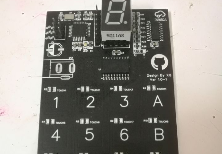

  • When DC 5V power supply is provided, press the button to get the corresponding display on the digital tube.
  • The SPI burning port and Serial burning port of the main control chip are reserved, supporting two methods of burning programs.
  • Leading out the I²C interface to facilitate secondary experiments
Component notes: R2-R4:R6-R18 are not connected under normal circumstances. If you need to discard a certain button, just short-circuit the corresponding pad.
J1 is a jumper pad. You can select the corresponding pad to short-circuit according to the common cathode/anode of your digital tube (it is strictly prohibited to directly short-circuit 3 pads!)

I received the PCB and the finished product is expected to be soldered within tomorrow. I found that there was an error in the log on April 16th, and the "common yang digital tube" has been changed to "common yin digital tube".QQ picture 20200420143526.jpg
2020-4-21
The welding is basically completed (except for the DC socket and solid filter capacitor) and debugging work is expected to start today.QQ picture 20200421080317.jpgQQ picture 20200421080313.jpg
2020-4-22
Suddenly I remembered that when the signal was put in the 74HC595, the first one put in was at the eighth position. I thought it was at the first position and QQ picture 20200422065004.jpgthe entire display program had to be changed.
2020-4-22
Suddenly the program cannot be burned. There should be something wrong with the BootLoader.QQ picture 20200422065328.jpg
