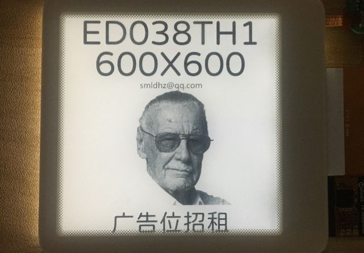

Modified from the open source project epdiy
The original two fixed screen holders are replaced with a 30p expansion holder, which can be used with an adapter board to drive more types of parallel screens.
At the same time, some components were modified to existing ones or cheaper ones. . .
Supported screens are as follows:
  • ED038TH1 (3.8-inch front-lit touch screen for a foreign smart home central control screen)
  • ED043WC3 (4.3-inch inkcase i7)
  • ED047TC2 (4.7 inch yota)
  • ED060SC4 (6-inch old kindle/commonly used for domestic 6-inch e-books)
  • ED0970C4 (9.7 inch kindle DX)
  • ED097TC2 (9.7 inches)
  • ED097OC4_LQ (9.7 inches)
  • ED133UT2 (13.3 inches)
Among them, 6 inches and above are supported by the original driver. I actually tested 4 screens of 6 inches and below. Some of them need to be modified for driver adaptation.
The modified board can use epdiy's original driver (some pin definitions are different and need to be modified)
Finished product
adapter board
ED038TH1 (with front light/touch)
ED043WC3
ED047TC2
ED060SC4
