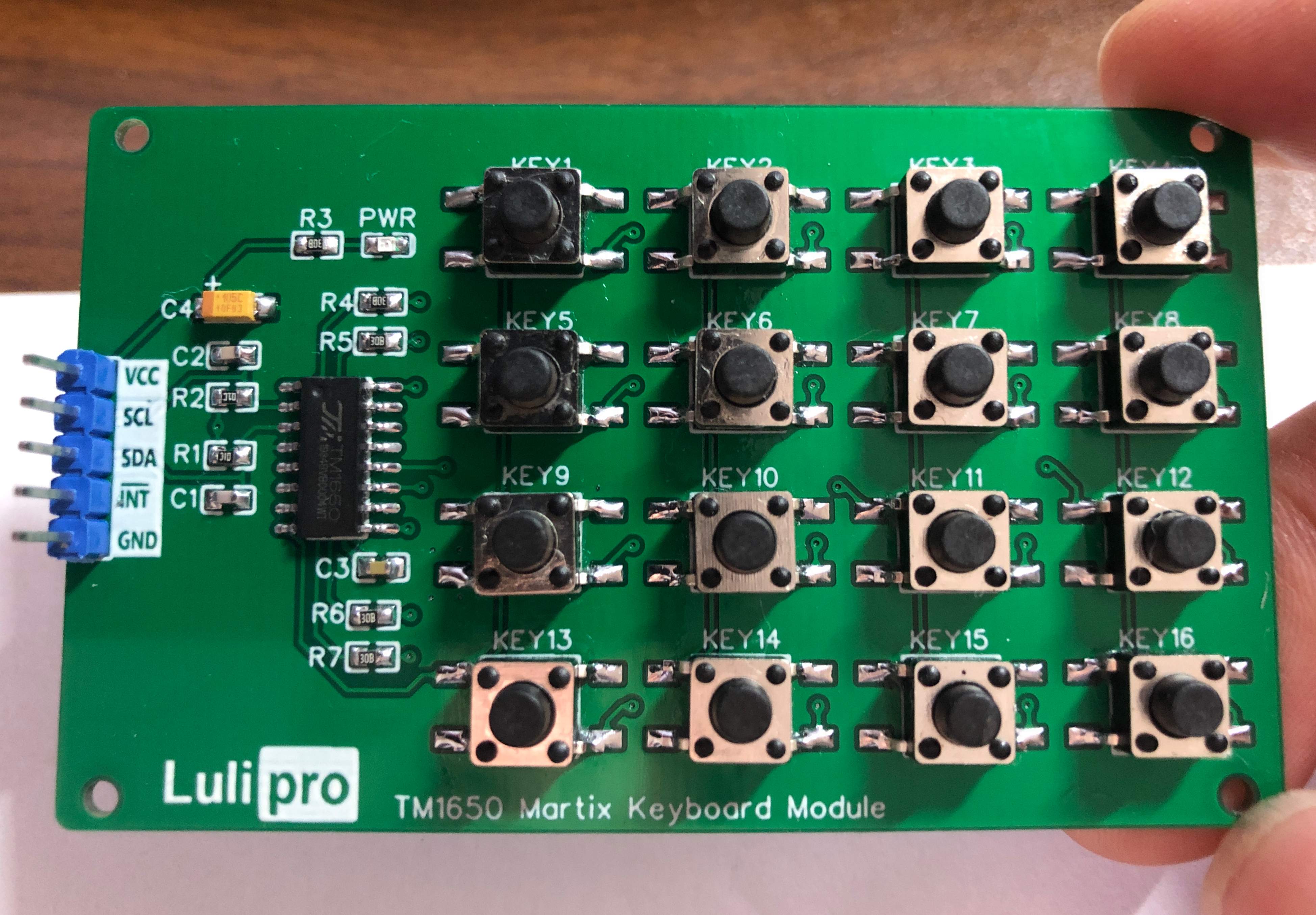

Introduction
4x4 matrix key module based on TM1650. Use the I2C interface to communicate with the microcontroller. When a button is pressed, the microcontroller is notified through a falling edge interrupt. It eliminates the need for button scanning by the microcontroller, saving valuable CPU time of the microcontroller; communicating through the I2C interface saves the IO of the microcontroller.
Module pin definition
  • VCC: positive pole of module power supply, 3.3V or 5V
  • SCL: I2C communication interface clock line
  • SDA: I2C communication interface data line
  • INT#: Interrupt output. It maintains a high level when no button is pressed, and outputs a low level when a button is pressed. Falling edge interrupt detection available
  • GND: module power ground
