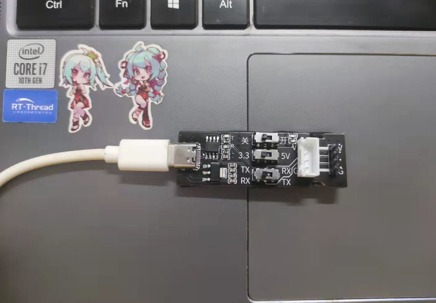

type-c to serial port miniTTL adjustable voltage, line sequence
It is easy to use in personal testing. Without crystal oscillator, the measured high-speed serial port is no problem. The measured baud rate of 1500000 is fully usable, 183k/s.
