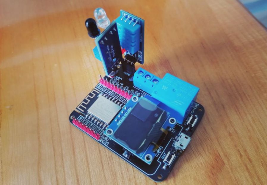

  • Temperature and humidity DHT11 measures temperature and humidity and automatically disconnects the relay when the temperature reaches the set value.
  • The relay can also be controlled by a photoresistor. When the brightness reaches the set value, the relay opens.
  • Added infrared sensor, you can control the on and off of the relay by swiping your hand on the board.
  • ESP8266 connected to Gizwits WIFI control
  • OLED displays current temperature, humidity, and relay status

5. Process records :
**update 8/13 **
I received the board in the morning and started soldering. I found that the direction of the DHT11 and infrared module interfaces was not very good and blocked the photoresistor, but it did not affect the use (the PCB has been modified)
The first time welding MICRO-USB was a bit challenging and I broke two boards (I learned a lesson: don’t be stingy with the rosin, just put it in as hard as you can)
When welding CH340E for the first time, be sure to pay attention to the chip direction. Be sure to pay attention to the chip direction. Be sure to pay attention to the chip direction.
There is a small spot on the package. I'm going to solder it now.
I started writing programs in the afternoon. I had watched Ji Xiaoxin’s ESP8266 tutorial and originally planned to use the AIthinker development environment.
Who knew that the live broadcaster Song Gong kept saying, kept saying, yes, kept saying that this software is outdated and should not be used anymore. It made me panic. Okay, I will use this one last time (I don’t know how to use other environments. It’s too late to learn other things. , it’s up to you, Bulbasaur~)

update 8/14
**Added some design features to the generated code **
1. The hand sweep controls the on and off of the relay: It is implemented using the interrupt method, and the falling edge interrupts. Each time the hand sweeps over the infrared obstacle avoidance module, the signal pin level changes from high to low, and the relay on and off is controlled in the interrupt callback function. break
2. ADC reading: This is very simple and can be implemented by directly calling the built-in api interface.
3. DHT11 measures temperature and humidity, which is COPYed from the Gizwits routine. It can be eaten directly and is very fragrant.
4. OLED display: IIC protocol and OLED code technology have direct COPY. I have added some Chinese character library Chinese characters and digital display functions.
We are afraid of affecting the underlying communication protocol (after all, we don’t understand the automatically generated things, so if it doesn’t affect it, it won’t). Here we use a software timer setting (functions executed in a task can be delayed by other high-priority tasks) and follow up every five seconds. New OLED screen data,
