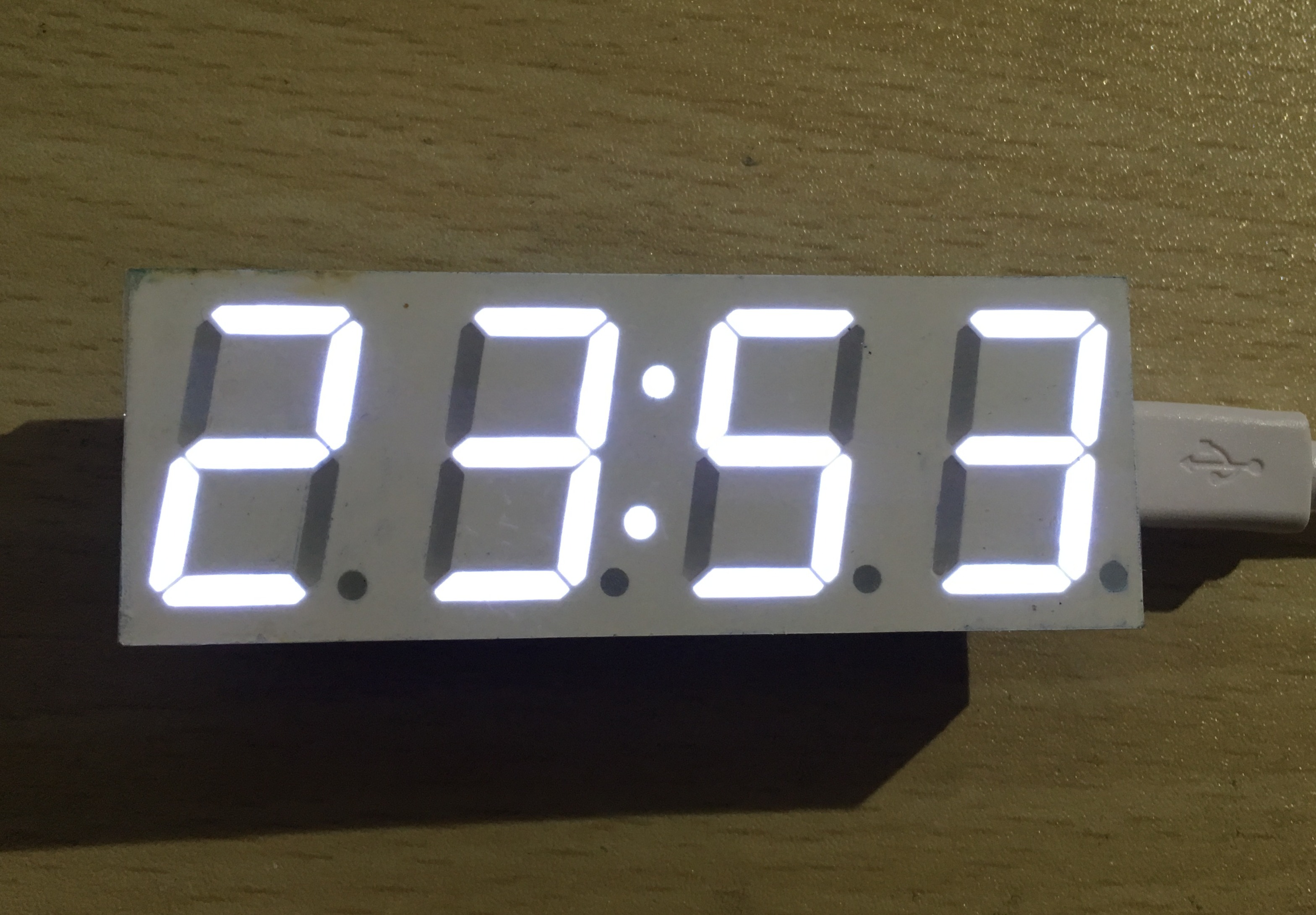

High-precision LED electronic clock based on STM32.
characteristic
  • 0.8-inch large-screen LED digital tube, clear display
  • Based on STM32F030F4P6 microcontroller
  • The RTC clock IC uses domestic SD3078, 3.8ppm, and the annual error is 2 minutes.
  • temperature display
  • Optional alarm and hourly chime functions
  • Optional automatic light sensing
Note: The source code is a TrueStudio project file. Please use TrueStudio version 9.3.0 to import it. If you do not want to modify the source code, you can download the binary file directly through ST-LINK. The file is located in the Debug directory.
Partial function demonstration
back: IMG_3096.jpeg
