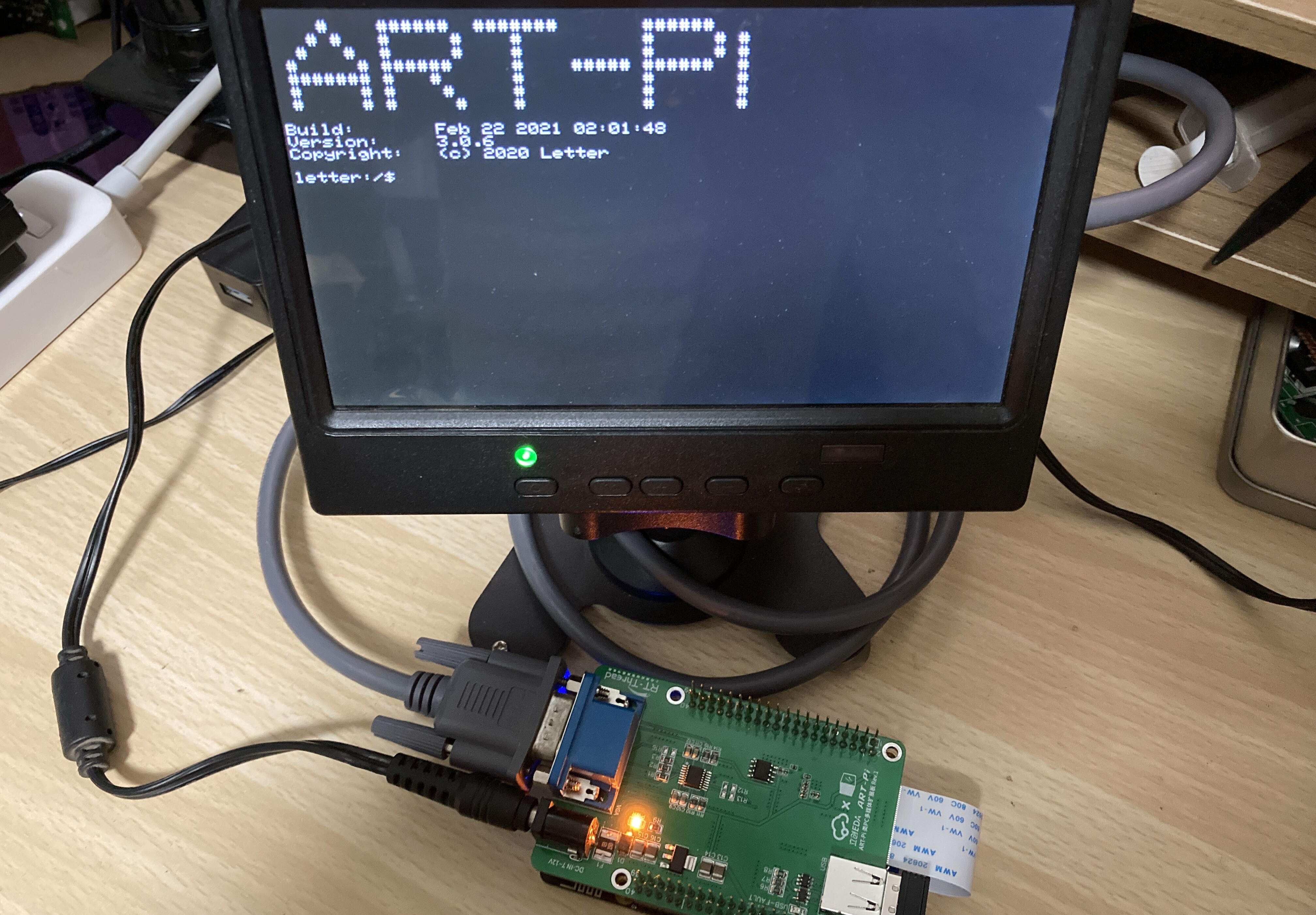

Finished product renderings display
PCB empty board diagram
Welding finished product picture
instructions
Basic command line environment
display image
play video
BASIC environment
Control GPIO via BASIC code
